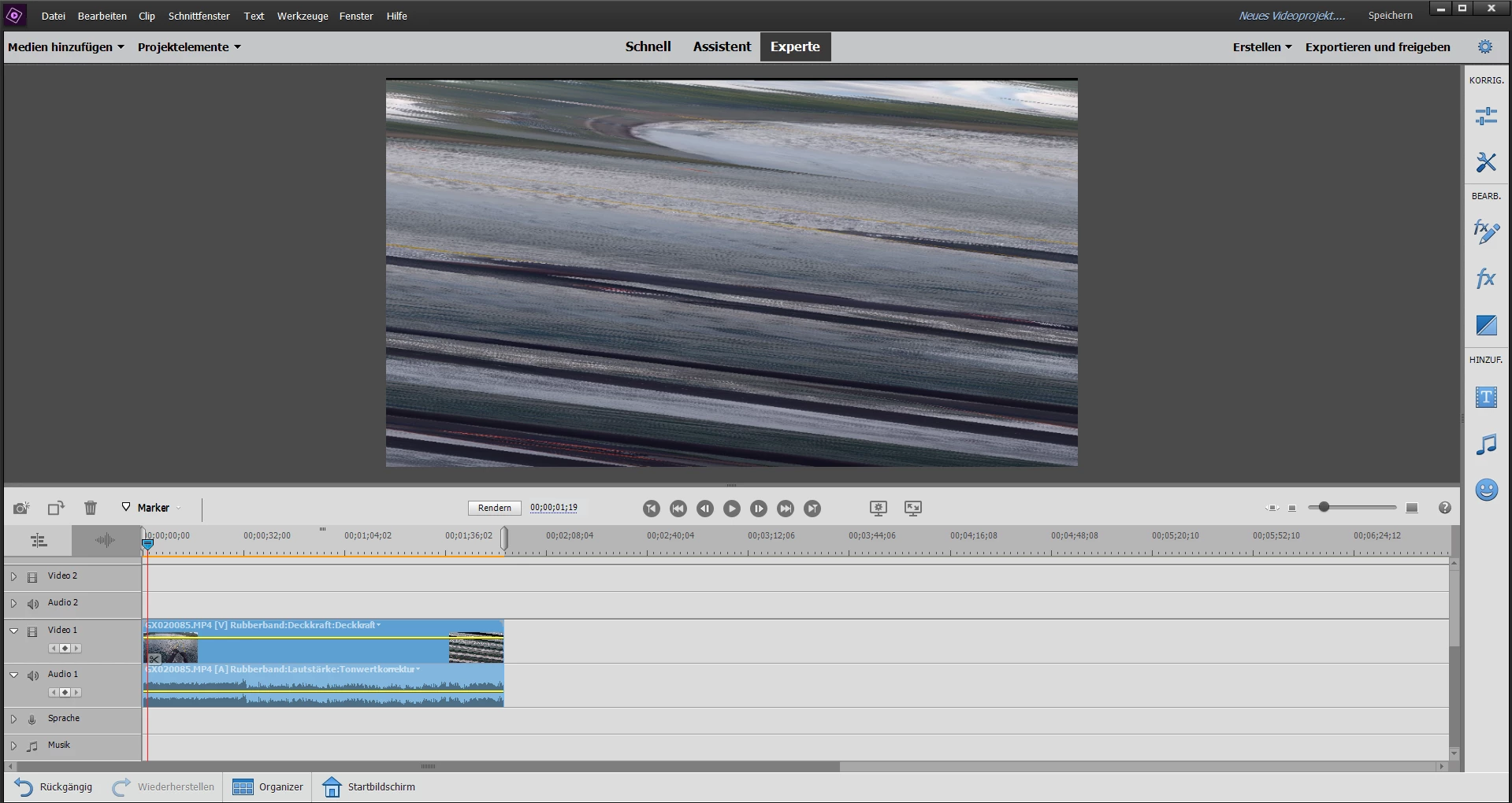

What should i do when HEVC media can be imported, but becomes blurry and gets stripes?
After finally being able to import HEVC media i get problems when i start playing it. It becomes blurry and gets stripes all over the screen. So all in all it's completely useless ..
Does anyone have a solution for this problem?
The footage is shot with a GoPro Hero 8 Black, in 2.7k 100fps and the lense is set to wide. I'm not sure if the 100fps could be a problem.
Any other media player works just fine with the same file ..
I doubt that it's a hardware problem.
My specs: i7-9700, MSI RTX 2060 6GB, 16 GB DDR4 RAM 3000 MHZ, M.2 SSD
Windows 10 Pro 64 Bit, Version 1903

Okay so i formatted my SD card that i use in the GoPro and shot for all of you 3 test Clips
https://www.dropbox.com/sh/u2g2r39aza86xyy/AACesMz5mQZ-rdULMjQbcX_Sa?dl=0
1) 50fps H.264
2) 100fps HEVC
3) 50fps HEVC
Clip 1 works just finde in Adobe Premiere Elements.
Clip 2 and 3 don’t work in Adobe Premiere Elements
So my computer obviously has a problem with the HEVC codec. Please tell me if the clips work on your computer 🙂

The intended way to establish project settings is to add some media and put a primary clip on the timeline.  Premiere Elements then picks the best match.   How are you doing it?
Icy_x3Author
May 24, 2020 4:31 PM UTC
Thats the way i do it.
When it didn't work i began to create new projects and change the settings. But it never worked. Could the 100fps be the Problem?
May 25, 2020 1:53 AM UTC
Absolutely. Premiere Elements does not have project presets for 100 fps video.

When you first add your HEVC clip to your timeline, is there a yellow-orange "render" line over it? Ideally there should not be -- at least until you add effects. A render line indicates that the program is not able to match its project settings to your video's specs, and that can result is the playback issues you're seeing.
Icy_x3Author
May 24, 2020 12:52 PM UTC
Hey Steve,
yes there is a yellow line. I've been experimenting with the project settings, but i wasn't successfull.
Can you help me with the settings? I shot the footage with my GoPro Hero 8 Black in 2.7k 100fps and the objective was set to "wide".
I didn't really find a matching setting in Elements 2020
