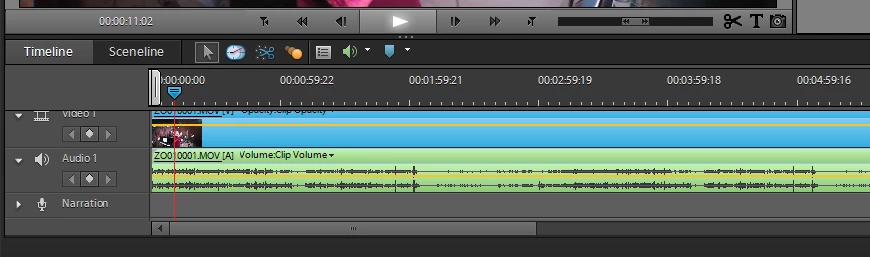

    My description of the problem would be the audio is out of sync with the video, sped up and stuttering.
    I'm using the same recorder, Zoom Q2, Premiere Elements 9, Windows 10 on a Dell XPS 15 with a NVIDIA graphics card.
    The camera settings were 1080p/30 fps HD and audio at 44.1 kHz/16-bit. The output is a .MOV file
    I've tried to manually change the settings to the one you advised previously, and I also allowed PE 9 to automatically change the settings to match the file.
    Neither was successful.
    I do not see the yellow orange render line as you described, although I do see similar lines going through the blue video band and the green audio band. I pasted a screen grab below.
    Thanks in advance for any advice you can offer.
