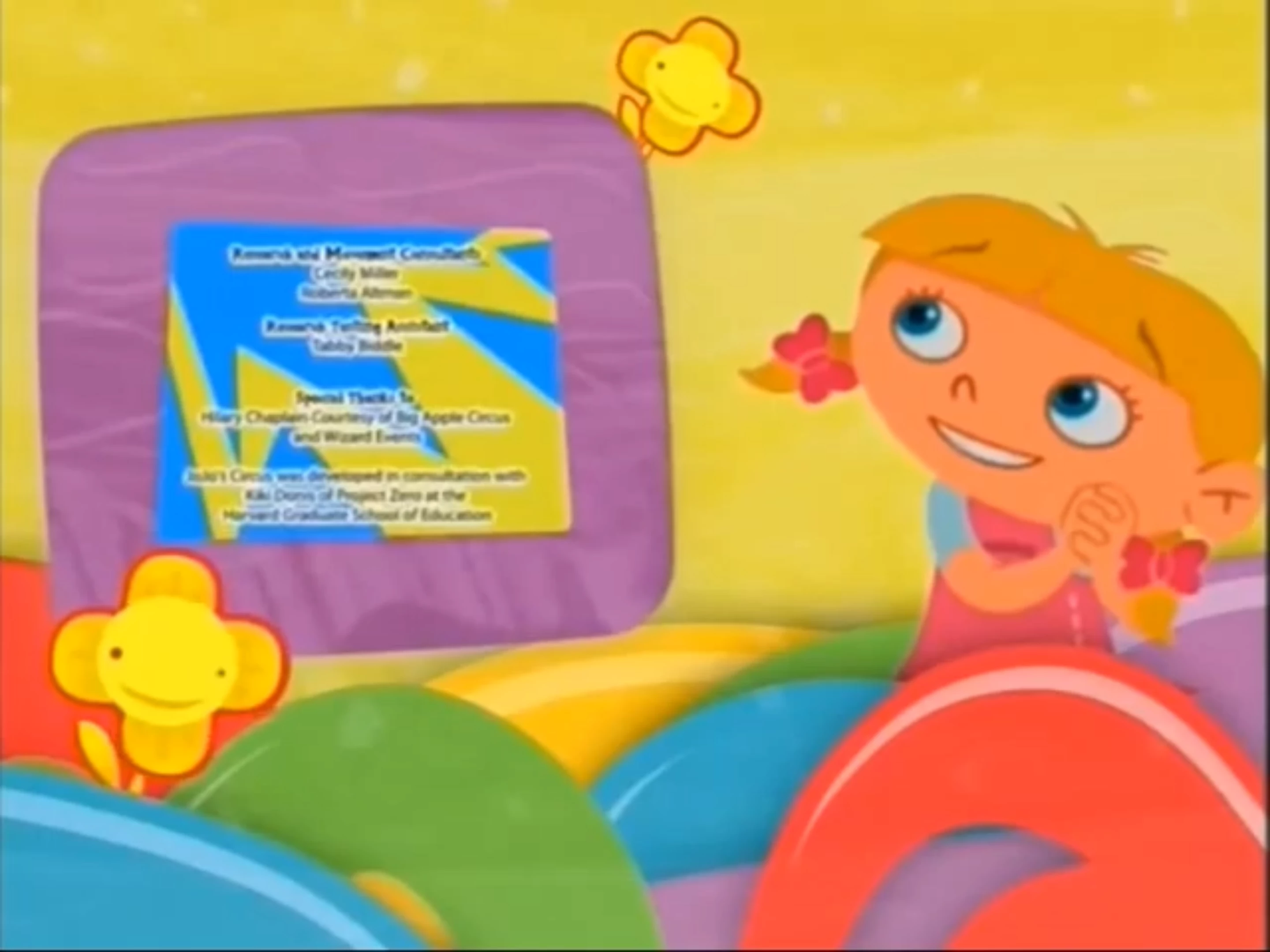

I'd like a 4:3 aspect ratio. Without it how will I made analog horror videos? Also Incase you don't know what I mean by 4:3, here's a screenshot from a continuity of Playhouse Disney's Polish feed from around 2010-2011 I found on YouTube.

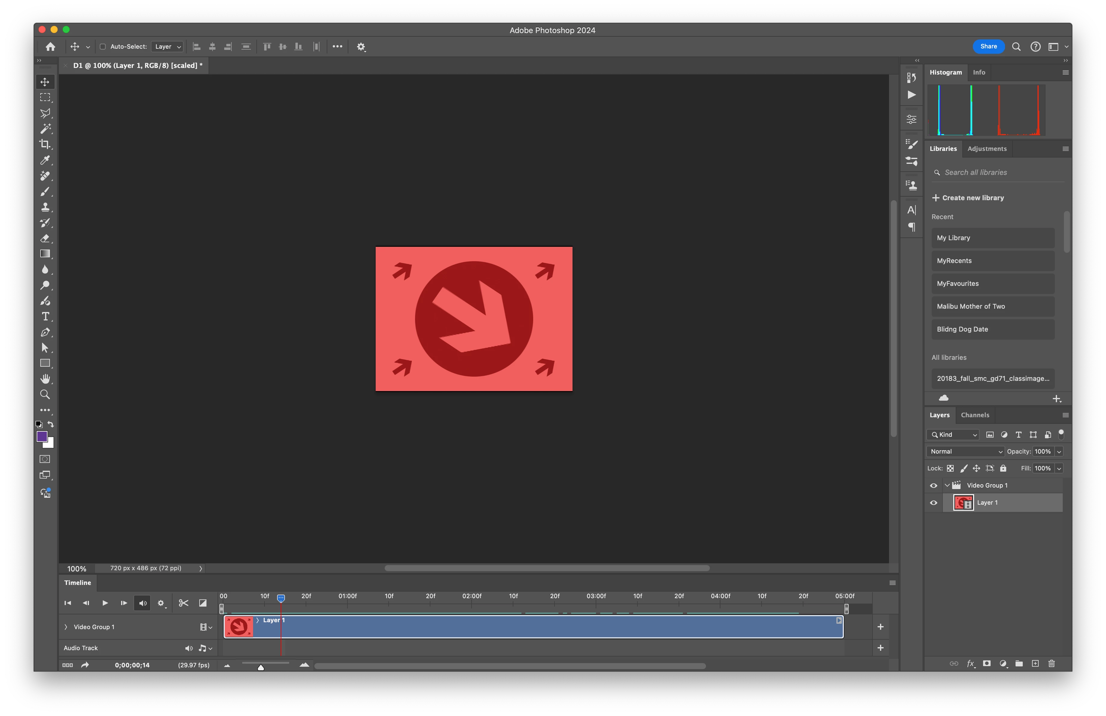

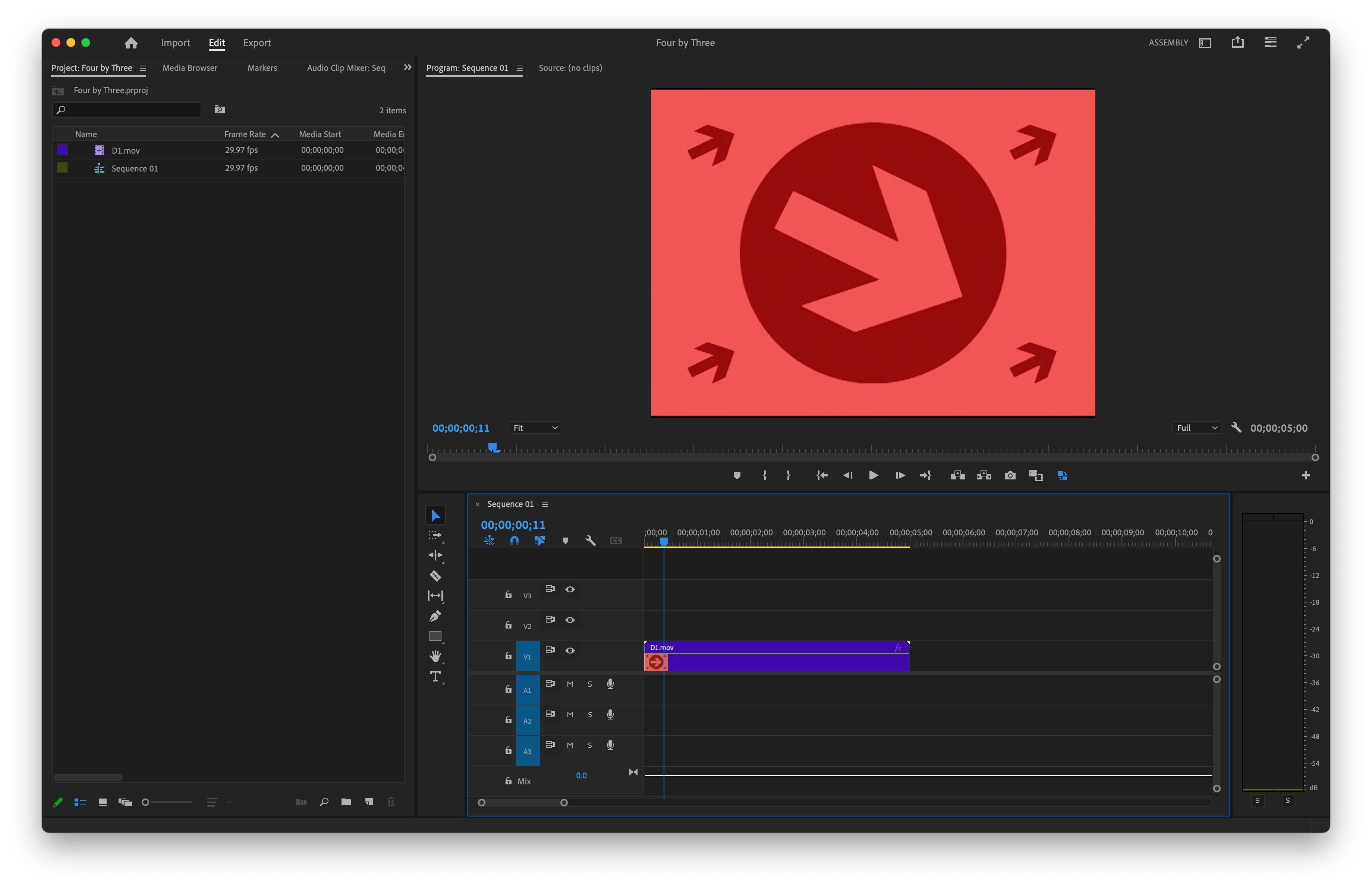

Premiere Pro supports a 4:3 Timeline as well as Photoshop and After Effects.
A technical note:  When using 4:3 source, it's a best practice to crop for overscan.  Your sample image shows a thin column of black in the picture along the right most edge that would not have been visible on a standard definition televsion set.
