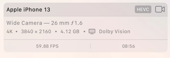

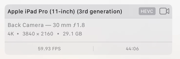

Hey Kevin, thank you for your reply.
I was able to finish the video; I separated it into 2-3 minute pieces and it crashed less often.
It is HEVC, one view from my iPad and one from my iPhone, and I've attached their details. I'm admittedly an amateur. Are these specific formats compatible?
