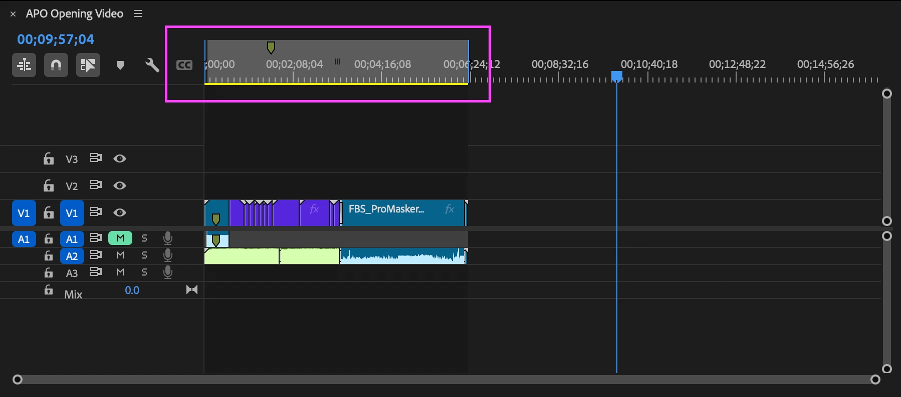

    I had a similar issue too where my video was 6 minutes long but exported to 16 min long, with 10 min being blank video. There were no stray audio or video clips in my file. To fix the issue, I clicked on the gray part where the numbers are, and shortened it to see the end of it and then correctly sized it to my actually footage.  It took a bit of clicking to get it small and then to expand it over the proper footage but it worked for me and i was able to successfully export my video. Hope this helps!

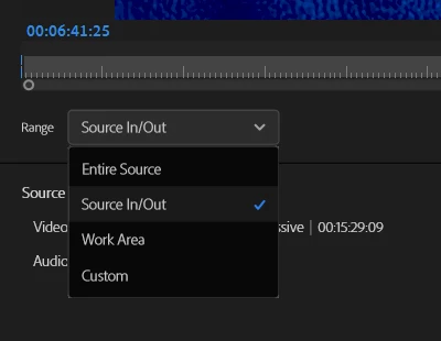

    when you open the export window there is an option under the video play back, it says range, with a drop down menu, use the option u need, like source in/out if you marked your video properly, or work area option, that was correct for me to........ my video droped from 5 hours to 2 20

    Check the Range setting when you export it, helped for me to change from Entire Source to Source In/Out! (Guess it's because the video was trimmed from 25 to 15 mins.)

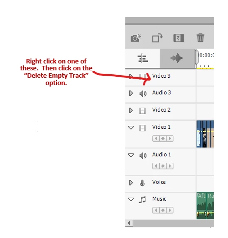

    I was thinking that there were frames of videos floating as well.  But, everything I tried didn't work.  Then I found this page and none of the suggestions here worked either.  Finally, I decided to delete the EMPTY tracks and that fixed the problem.  Now, keep in mind that if floating frames were on the tract, they would not be EMPTY!  So, this should not have fixed the probem but it did.  If it works, it works! lol
