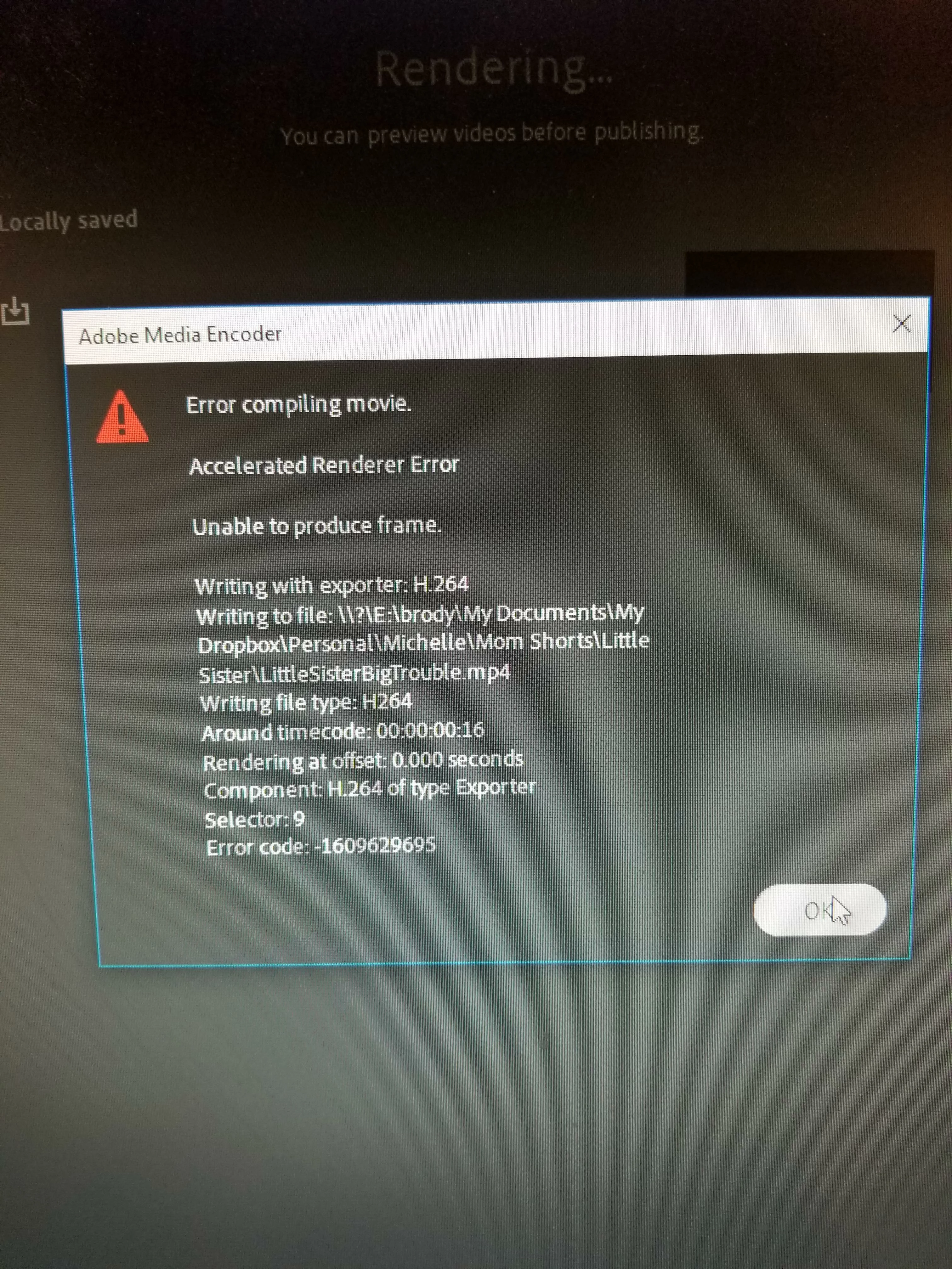

Error Compiling Movie, Error Code -1609629695
I am doing the trial version right now. My movie won't download. I have tried deleting all transitions, text and music. I have deleted the clip at the 16 second mark (according to error message below.) Nothing will allow me to dowload! Once it downloaded part way through a clip and crashed. So I tried deleting that clip but then it just crashed at a different clip in the same general area. Please help! I don't want to starting paying the monthly fee if this is what the product is like.

March 15, 2019
Hi MichelleT!
See how that error window says "Around timecode: 00:00:00:16"? That's the program telling you where the error is occurring. What's happening on your timeline 16 frames in? Does that timecode on the error window change with each export?

March 16, 2019
No it stays the same, even when I deleted everything but 8 seconds of
footage (so there was no 16 second mark, but it still said 00:00:16).
I deleted all the subtitles and the intro video a friend made for me and it
finally downloaded. But I need those pieces.
