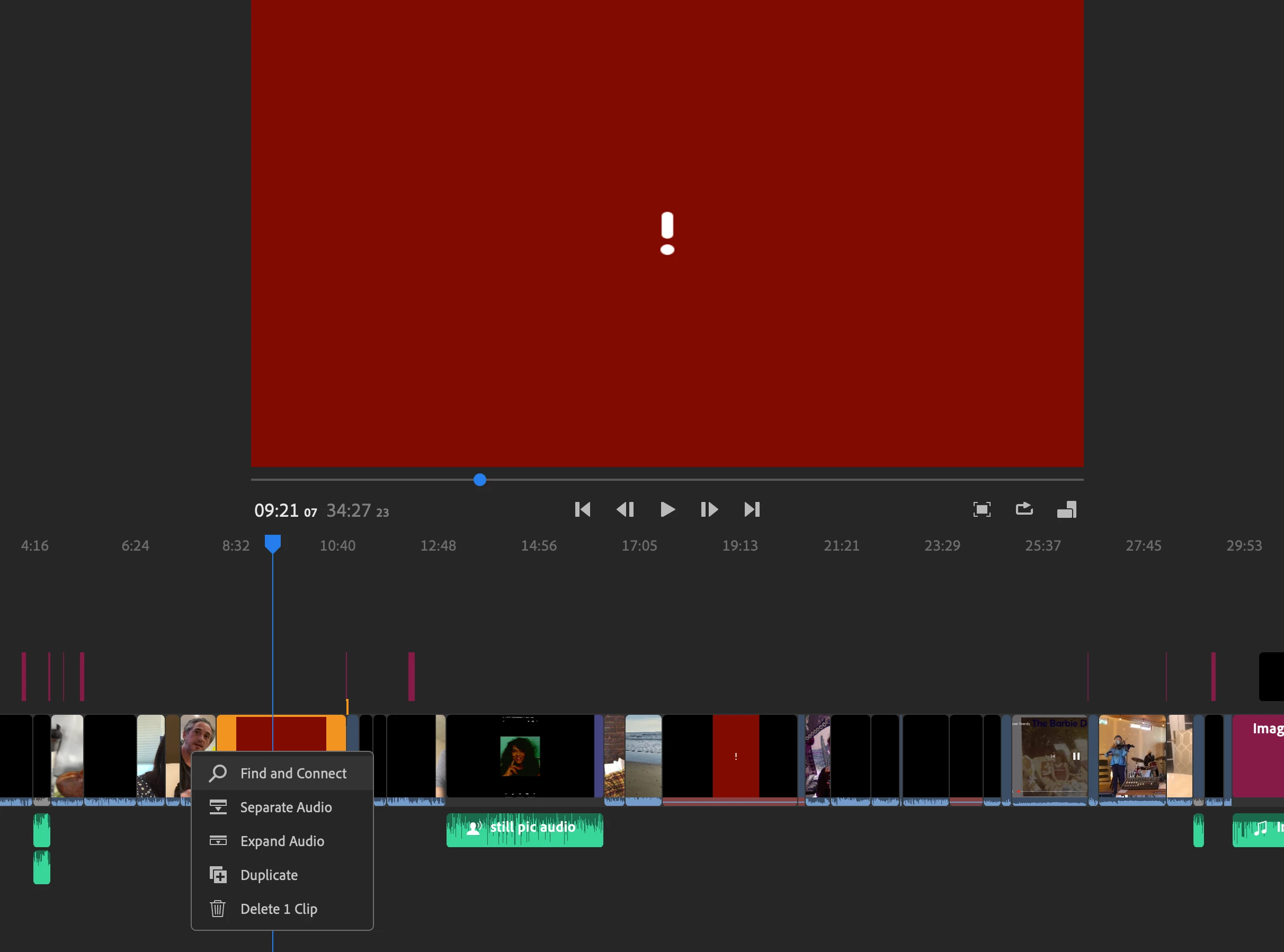

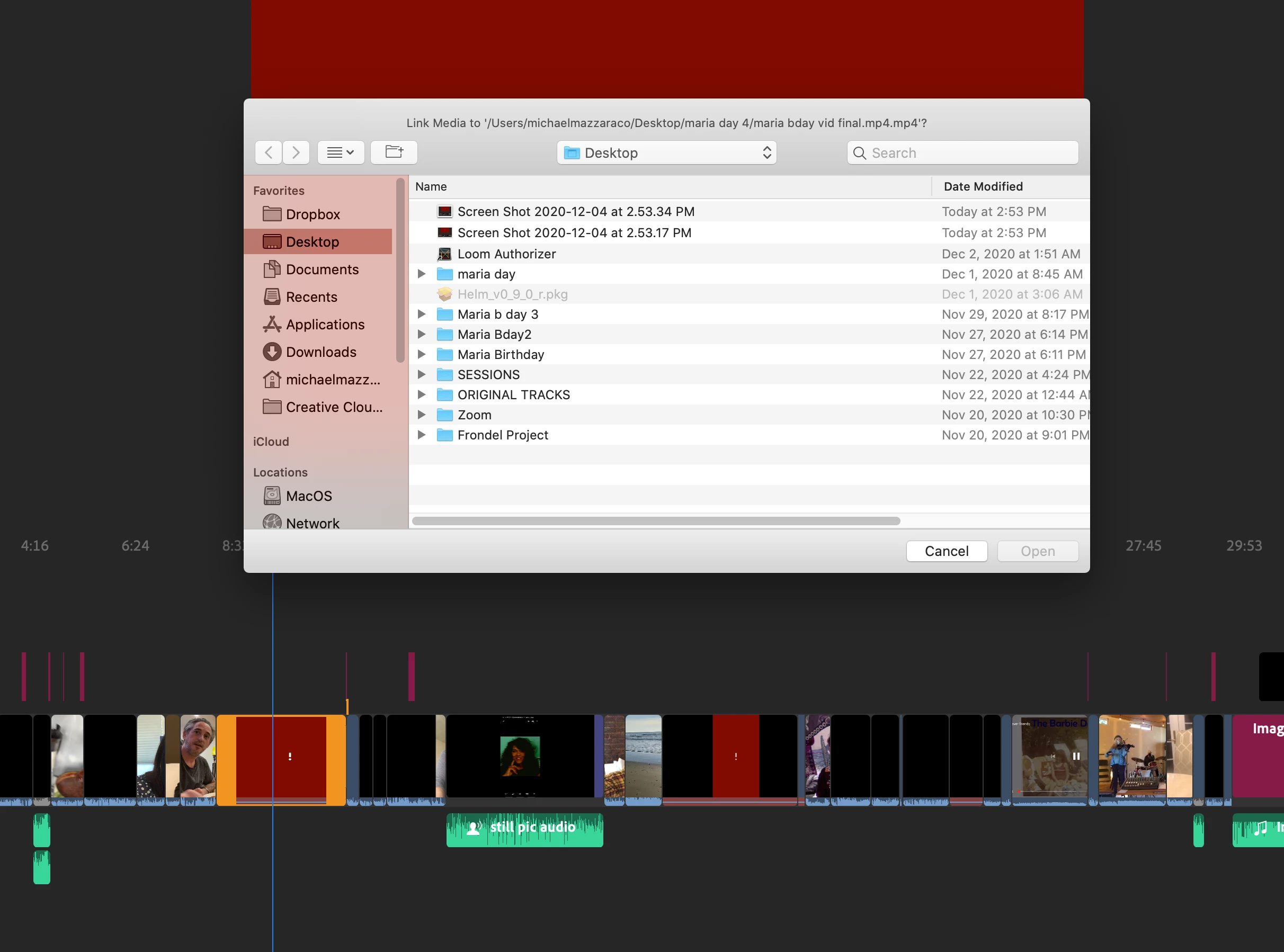

Hi everyone.  I've worked in audio for decades.  Just did my first full length documentary in media composer.  After thinking media composer would be a logical transition after being so well aquainted with Protools, I have to say it was quite a challenge to use their software!  The reliability and crashing I experienced as well as the lack of support made me search for other alternatives.  I plan on using premiere in the future but I recently purchased Rush to work on a small birthday video.  While trying to manage multiple importd of media from my client, I too found the need to reorganie my files mid project.  I found this thread to help resolve my issue and am dissapointed with the support that was given.  I'm happy to say I found not one, but MULTIPLE solutions WITHOUT HAVING TO RECREATE THE ENTIRE PROJECT!!!!!  Whoever suggested that should be EMBARRASSED to offer that as tech support.  Solution one requires restoring the original file path that was created before folders were relocated or renamed.  Screen shot 1 shows the file not being found.  Screen shot 2 shows right clocking or control + clicking on the clip that is missing and choosing "Find and Connect".  If you renamed or moved a folder and can't remember the exact location or name that was used, Screen shot 3 shows the  EXACT file path it's looking for on the top.  This allows you to reset that location specifally.  In my case that was good enough.  For someone who creates a new location for ALL MEDIA, it's a little more involved, but you can redirect EACH FILE to a new folder based on screenshot 3.  Just right click on each missing file, choose Find and Connect and redirect each one until they all recognize the new location.  I hope this provides some kind of meaningful help for those of you with the same issue.
