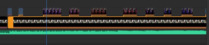

How do I unassociate/unlink different video layers? It's quite annoying, different video layers are just randomly linking themselves, so whenever I try to cut, move along the timeline or delete one of them, the one above (or sometimes all videos above) will behave accordingly.

@Sapatus Agreed, but if it's the main/default layer that you need to move, locking all other layers will still not allow you to move the clips down the timeline. See my video attached: The main layer in which other layers are linked to with that orange line bounces back to its original place even with everything else locked. How do I solve this or do I need to start over?

You have to lock the layer that outht to stay in place. Then you can move the other layer freely. You can lock a layer by expanding the layer view on the bottom left (three bars) and then click the lock symbol on the layer you want to lock.

Thanks a lot - it was right there in front of me the whole time and I didn't notice the lock icon.
