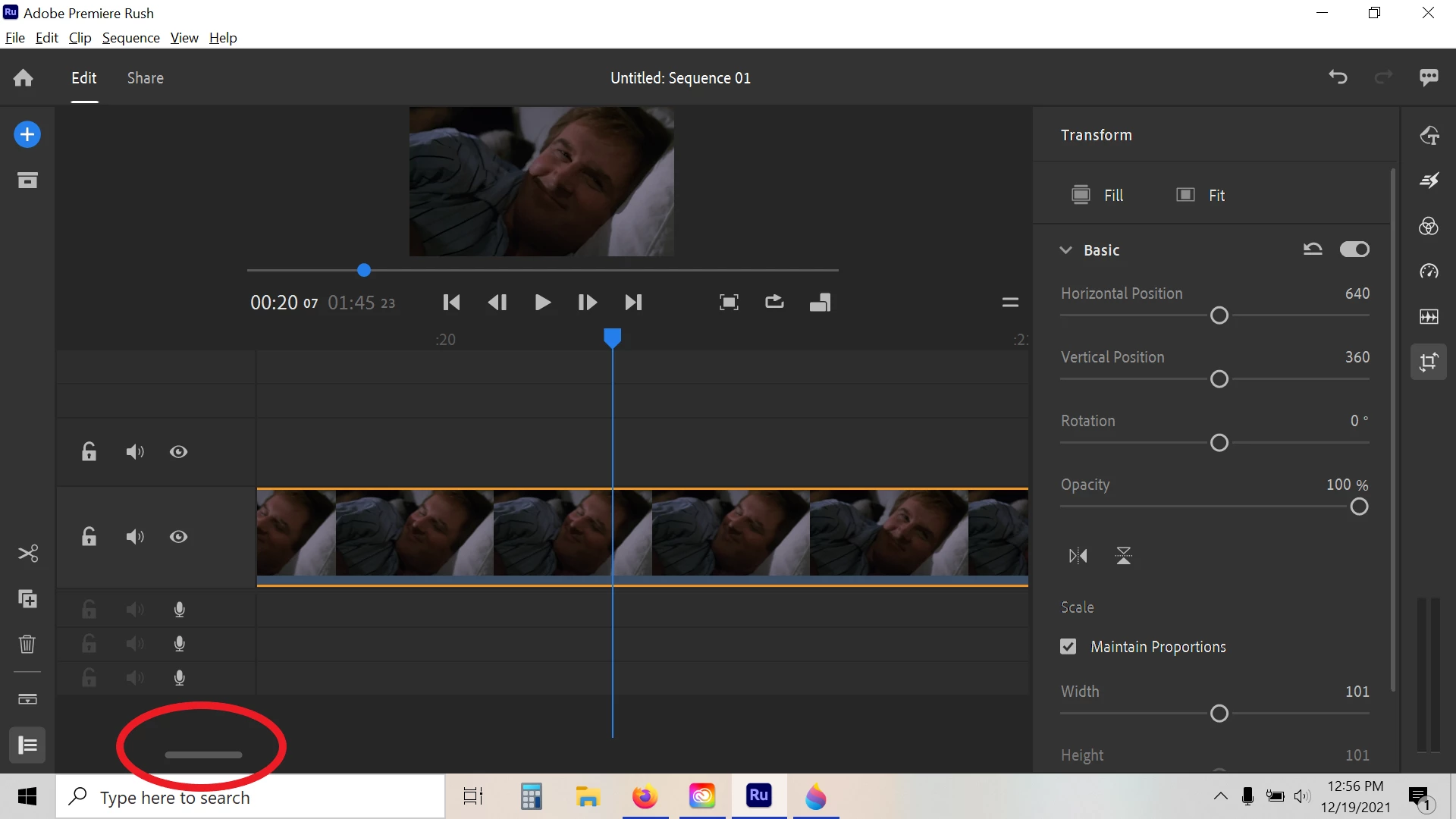

Hi there! I think I discovered a solution to your problem.
There is a bar at the bottom of the timeline. Dragging that bar to the right or left "magnifies" the clips on the timeline.
I've attached a screenshot. The red circle shows where the bar is. Manipulate that a bit, and you should be good!
I hope this helps.
I hope this helps.
Oct 5, 2022 3:43 PM UTC
Thank you for this hint!
