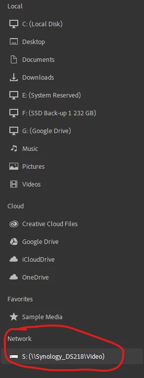

You will have to mount (access) the drive first via the Operating System.
Probably the easiest fix for this is to:
1.  In Windows Explorer, click on the Synology, and expose the share folder(s) in the main panel.
2. Right click on the share/folder icon inside the main Windows Explorer window, and select "Map Network Dive"
3.  A dialog will open.  You can then select how you want it mounted.  I suggest you leave all the setting alone (unless you know what you are doing) and turn on "Reconnect at sign-in" so that the NAS is automatically connected when you log into the computer.
4.  Close and relaunch Rush if necessary.
You should now see a drive pointing to your Synology under a drive letter.
January 5, 2022
The steps worked (mapping the network drive)!  Thank you both for your help, it's a lot more straight forward for me now.

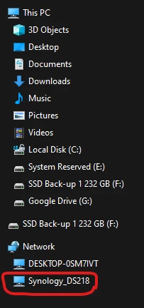

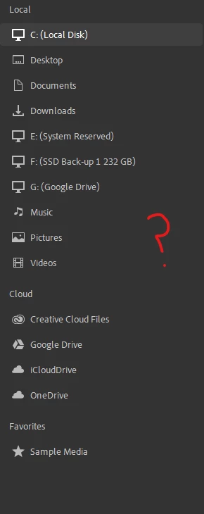

Apologies for responding (since you asked Cody directly), but the main issue is when we have our main video files stored on a NAS drive (see first screen shot with my Network Attached Storage circled) isn't available for us to initiate a project within Rush (second screen shot).  To get around this issue, we must move/copy the files to some other location, which is a hassle.
