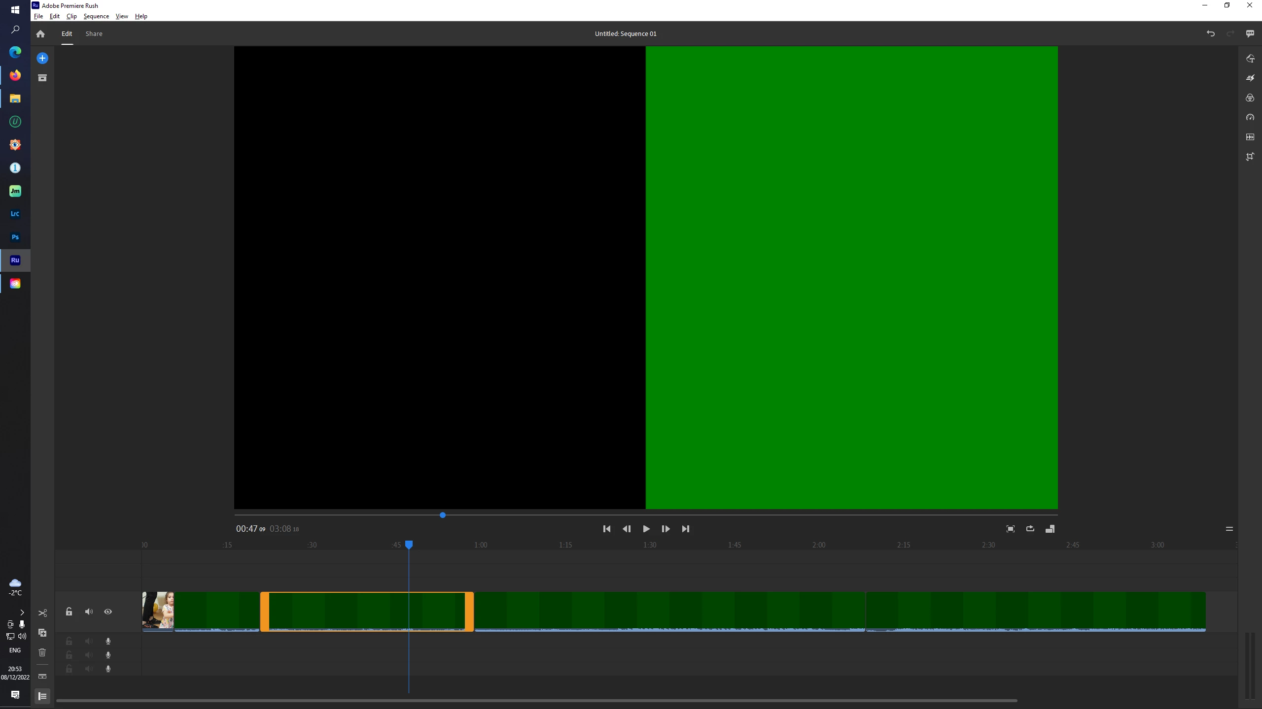

I filmed a few short clips with my iPhone 13mini in the Cinematic mode, I downloaded them to my PC from my Cloud account and I added them into Rush.
The sound is ok, but there is no video, there is just a green background. The first clip that is "seen" has been filmed with a photo camera.

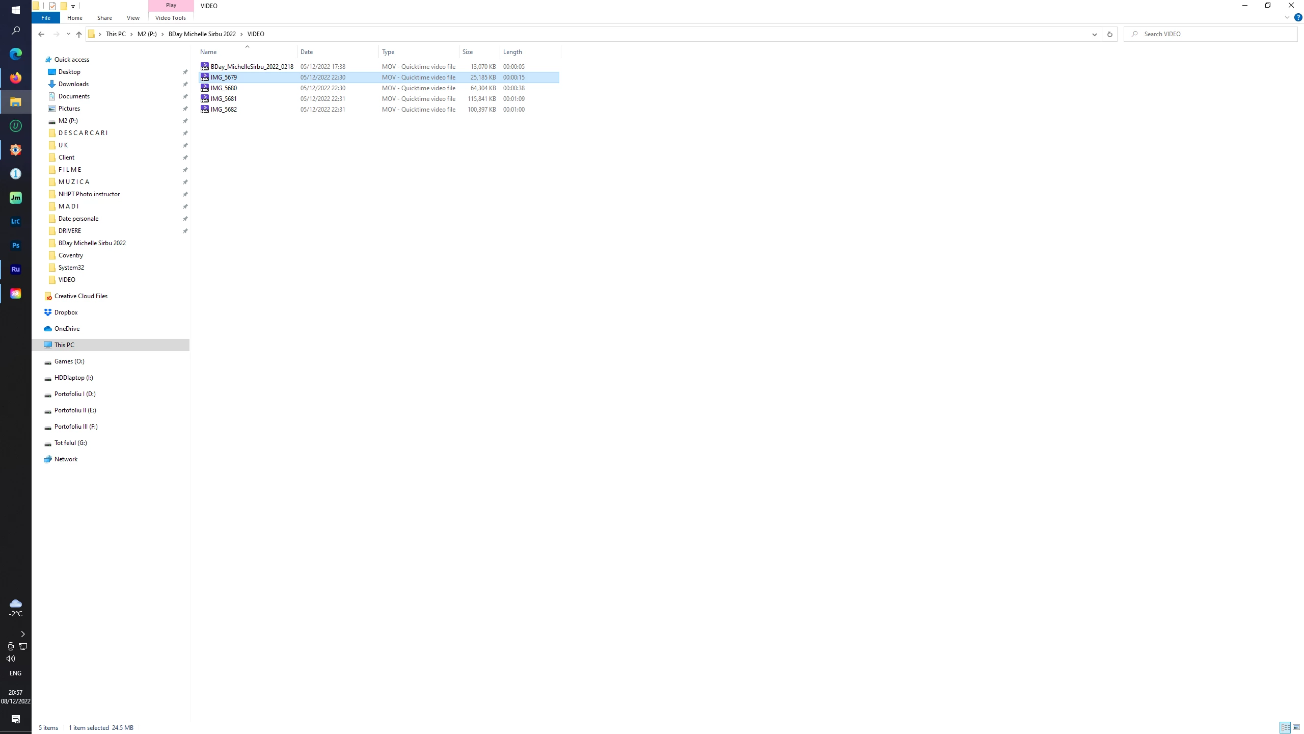

Also, all of the clips show as MOV as you can see in the screenshot below

It's fixed now - I had to buy the HEVC Extension from Microsoft and to give Rush a bit of time (couple of minutes) to acknowledge it.
