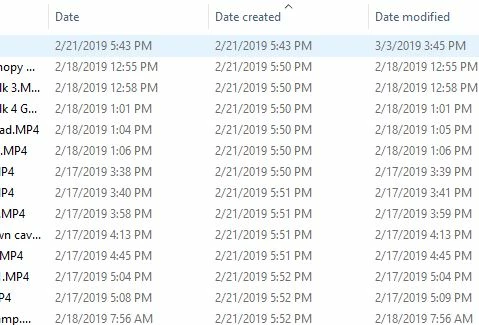

Hi there, I need some further clarification on your response.  You mentioned that the two methods of sorting are Alphabetical and Media Type, however there doesn't appear to be a Media Type sort function.  The two methods are by NAME (alphabetical) and BY DATE.
I did some further investigating as to how exactly my files were being sorted when I click on BY DATE.  It seems they are being sorted by Windows idea of DATE CREATED opposed to DATE.   You can see the difference below, as the DATE is when I actually shot the video clips and DATE CREATED is when I transferred them to my computer.
I'm not sure why they transferred in a different order than they were created, may have been me going through them one at a time and deciding which to transfer, however it would be much better and make things so much easier if the sort function was based on Windows DATE metadata.
As a bandaid fix for this issue, I renamed all my clips with a preceding a1, a2, a3, a4, b1, b3, b4, etc to have them sorted correctly by NAME.
