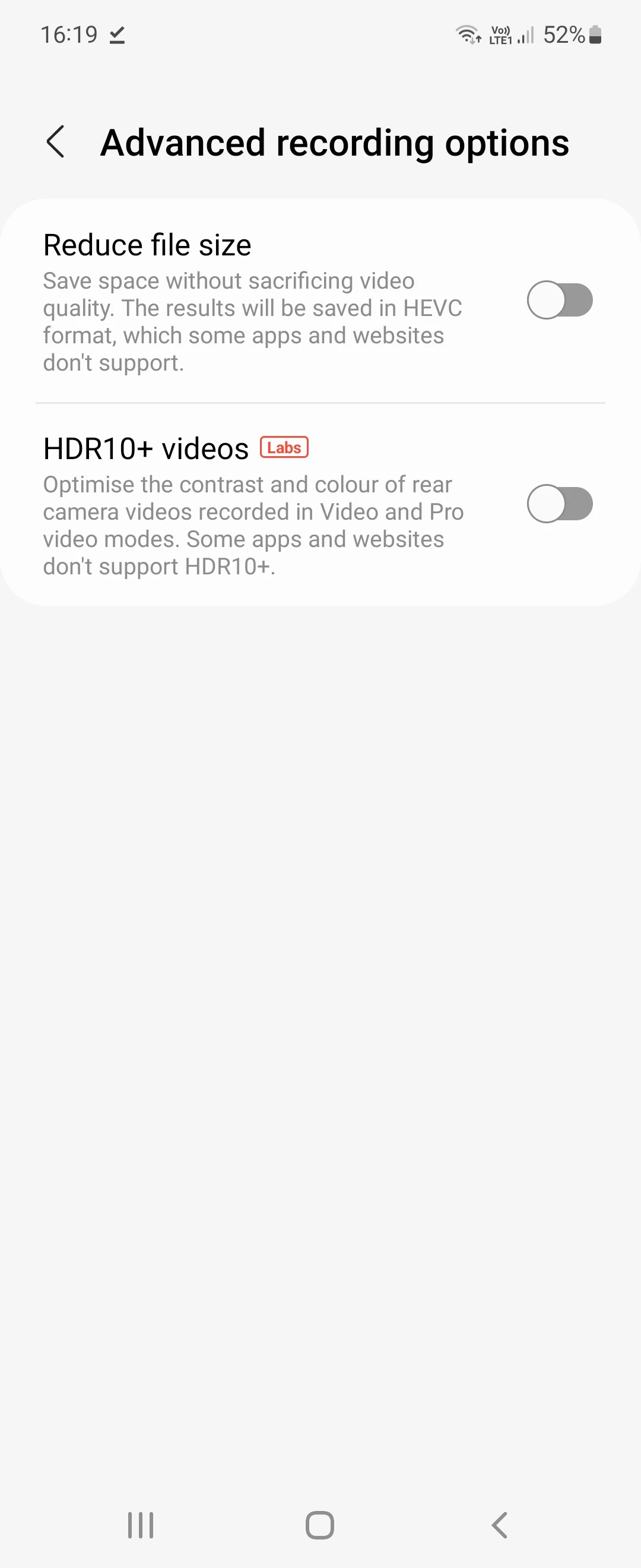

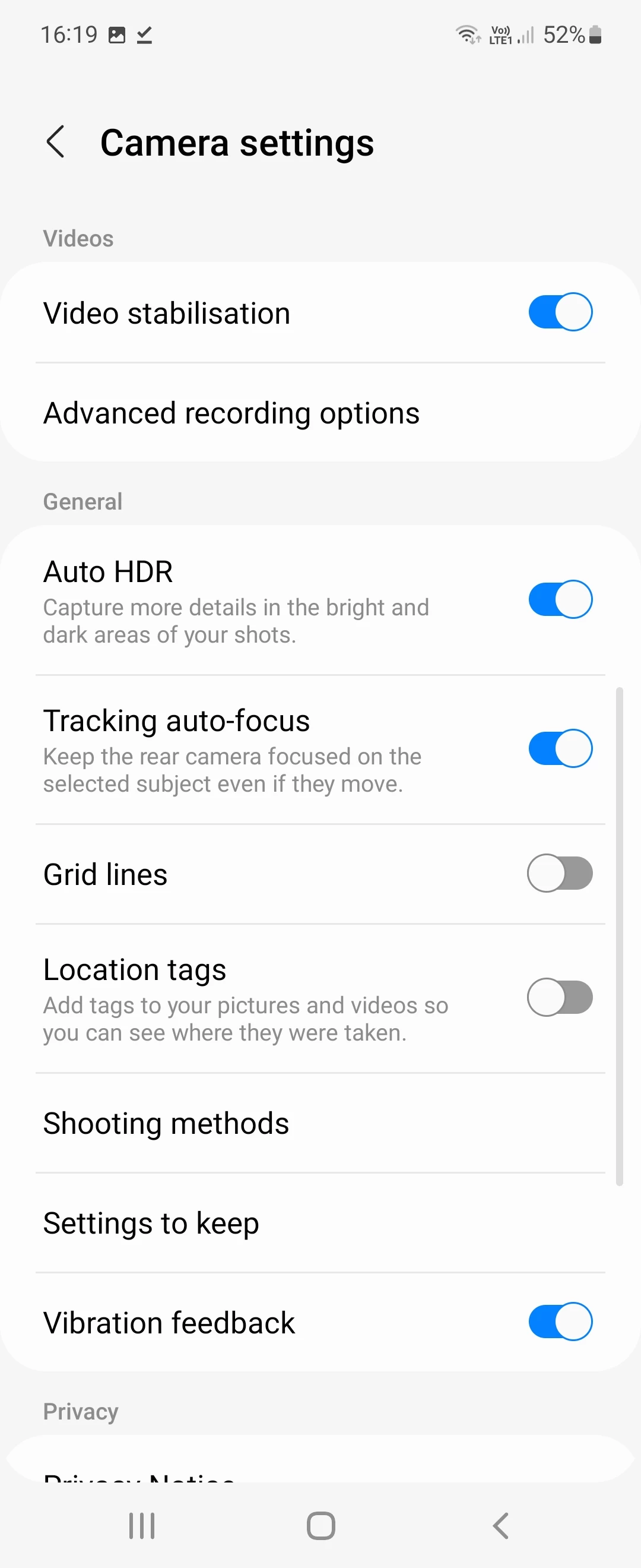

August 12, 2022
I had this same problem with Rush on my Samsung Galaxy z-Flip. The solution was imilar, under Advanced Recording Options turn off HDR10+. It says "some apps and websites don't support HDR10+". I've left the HDR (normal HDR) enabled
