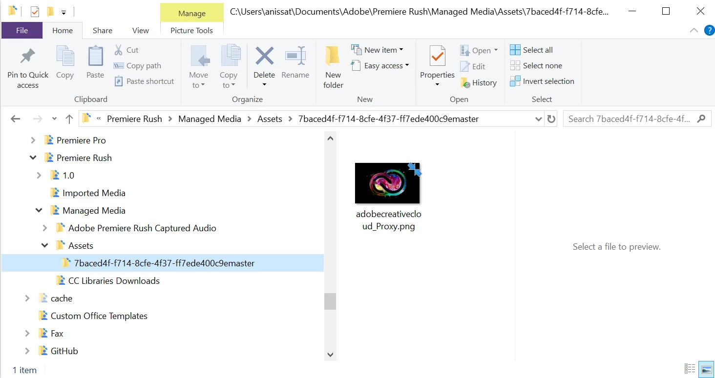

    anissa_thompson
    Sep 13, 2019 5:36 AM UTC
    If you're on a Win 10 setup, check out the following path:
    C:\Users\[youruseraccount]\Documents\Adobe\Premiere Rush\Managed Media\Assets
    Inside, you should find a folder for each local Rush project you've created on your machine (each has a long random character name) containing the sequence's proxy media:
    Hope this helps! Make sure to press "✔ Correct Answer" on this post if this answers your question. Happy Creating!Anissa • @anissat
    Sep 13, 2019 11:58 AM UTC
    Thank you, Anissa. The folder you directed me to holds proxies of the assets I'm using in my projects. However, it does not hold the locally saved Rush project files themselves.
