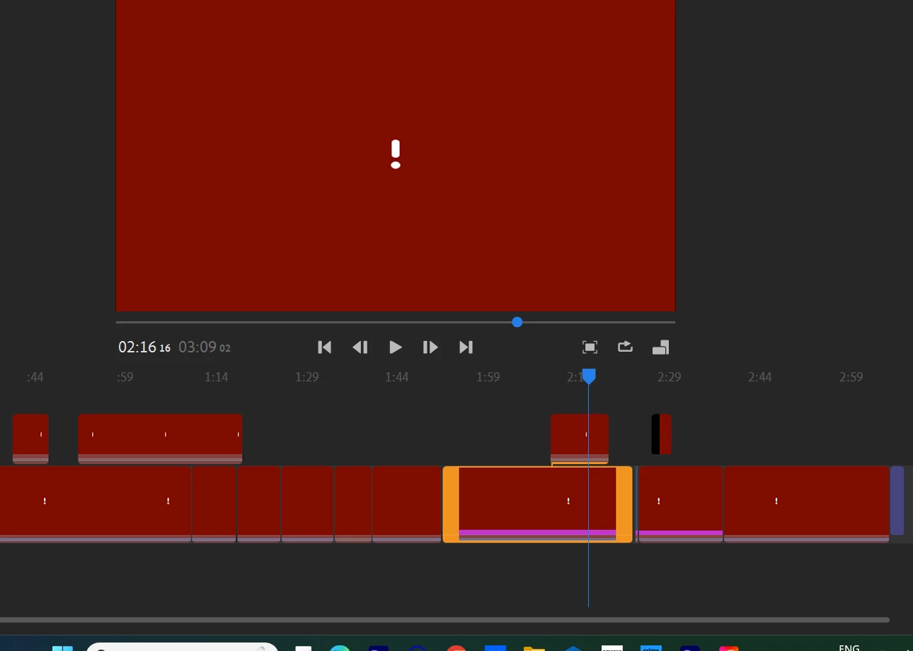

Why is this happening? Red Screen with !
After paying so much money for an Adobe plan, this is what I get? None of the fixes online help. Ive done the updating and the "Use optimize clips" technique, but nothing works. Adobe should fix this as it has been a known problem for years, especially since it isn't cheap!

It looks like you moved your media files. Right click each clip and reconnect them back with the original media. That will work.
