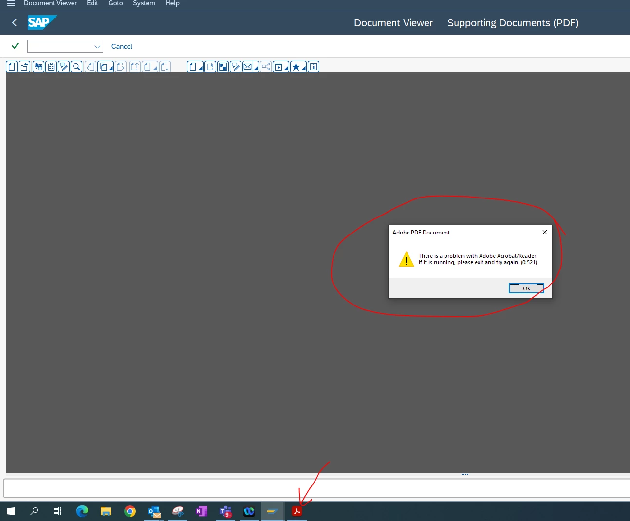

We Are facing an Issue when Employees are Opening multiple files in a row, within SAP Causes (0:521) to popup. it requires opening task Manager and ending the task to open the documents again.
We've tried the solution on the forum Regrding disabling "Run in AppContainer" and issue was still appearing.
we have disabled "Enable Protected Mode at startup (Preview)" and "Enable Enhanced Security"
but still same Issue.
Adobe Version (2022.003.20314 | 64-bit)

I found that we had this problem only if we were on a 64 bit version. If you are on 32 bit then it works fine. The problem is that the 32 bit version is no longer supported since January. But I can't contact anyone to find an answer to this problem.
