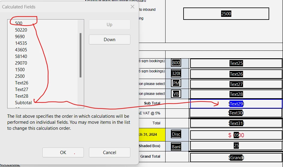

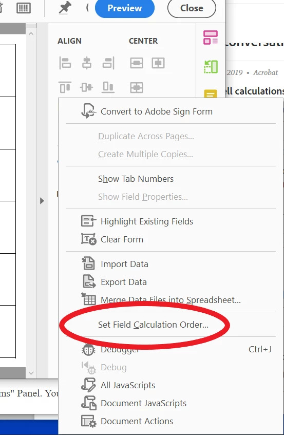

The script looks good. There might be a calculation order issue.
Make sure the field that recieves the data comes before the total field.
Thom Parker - Software Developer at PDFScriptingUse the Acrobat JavaScript Reference early and often
March 25, 2024
First, let me thank you for this invaluable assistance.  As a novice, I have built this entire contract with posts from other people in your thread.  You are truly my hero becaue my boss thinks I'm brilliant!
Yes I believe I have the order correct (see below).  The odd thing is I coped this script (and tweeked it a bit) from another post, the following coding isn't even on my document, but when I remove it the code stops working: this.getField("fullpageadregular").value!="Off.
"Fullpageadregular is not on my document it just happend to be in the code I found an copied, but strangly enough when I remove the line of script, my code no longer delineates between the two box, and only one amount is displayed, regardless which box is selected.
March 25, 2024
REORDERING WORKED!  I REORDERED EVERYTING EXACTLY AS IT APPEARS IN EACH LINE ITEM ON THE DOCUMENT, AND IT'S PERFECT!  OMG THANK YOU.  I had this problem with another line item, and it corrected that one as well.  THANK YOU MY HERO!
