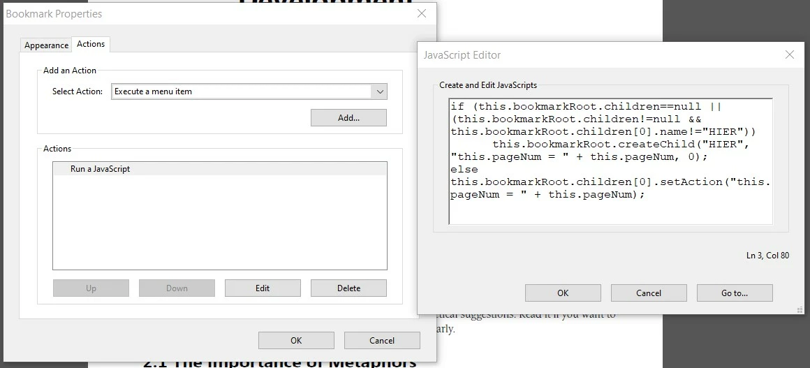

I have added the script to the bookmark,
Finished with twice OK.

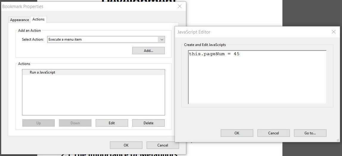

Now how do I run this script, so the bookmark "HIER" receives the current page as Destiny?
Do I double-click the bookmark? In that case the script changes to:
(forgive me my ignorance, but I've never worked with script in Acrobat before)

Sorry, I wasn't clear enough. That script should not go under the bookmark, because it will get overwritten, as you saw.
You could run it from the JS Console, for example, or even from a menu item or toolbar icon (although you'll need to adjust it a bit and place it in a .js file on the local computer).
