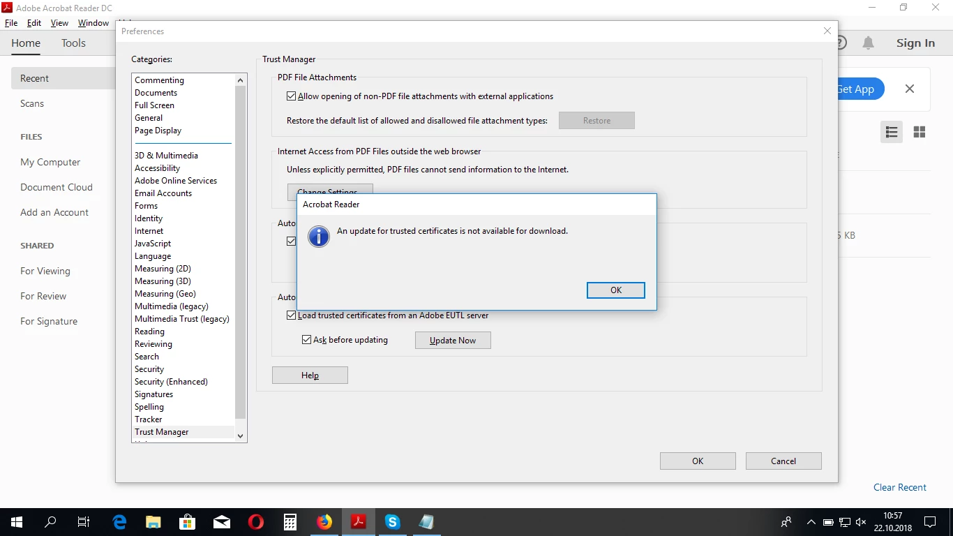

I have trouble updating (and with that, receiving) AATL and EUTL lists.
When I press the "Update now" button in Trust manager, nothing happens. Thanks to this, all signatures look invalid on the computer.
Notes:
- Issue present on 2 computers (possibly more) I have tried the proposed solution in a different thread (using Adobe cleaner tool and reinstalling) on both device but it didn't help.
- Both run Windows 10 64-bit, other devices of the same type and connected to the same network don't have this issue.
- On one computer the issue is present both in Acrobat Reader DC and Acrobat Pro DC.
- I have contacted Adobe Tech Support but they didn't know how to help me. (I can provide case number via DM, but I have written all necessary info here)
Thank you in advance for any ideas how to solve this issue.
P.S. I am reposting my issue because the other thread is marked as 'solved'.

Update: When I booted one of the machines, this is the error I got: "An update for trusted certificates is not available for download."
