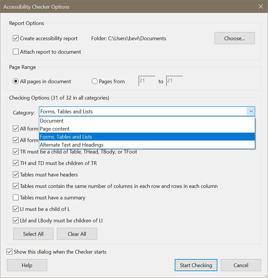

As Rachit suggested above, the differences could be due to how you and the professor configured your Accessibility Checker settings. Make sure they are the same. We recommend checking everything listed in all 4 sections, except for summaries on tables which is optional per the accessibility standards.
But it also could be due to different versions of Acrobat you both are using. Earlier versions of Acrobat's accessibility checker wouldn't flag some of the issues you describe. We recommend using the latest version of Acrobat Pro in order to be more compliant with the standards.

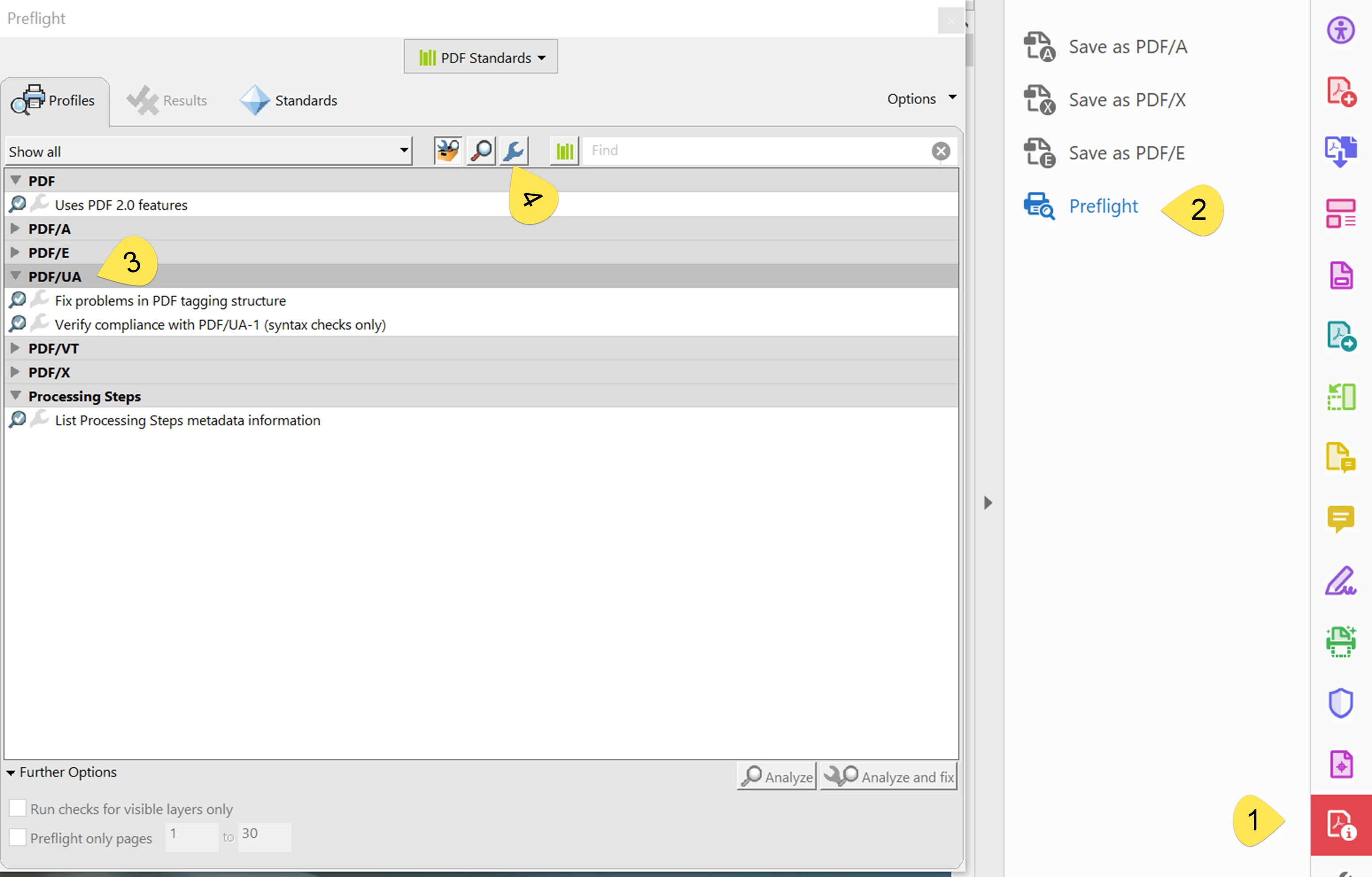

You might try running the PDF through another accessibility checker, such as:

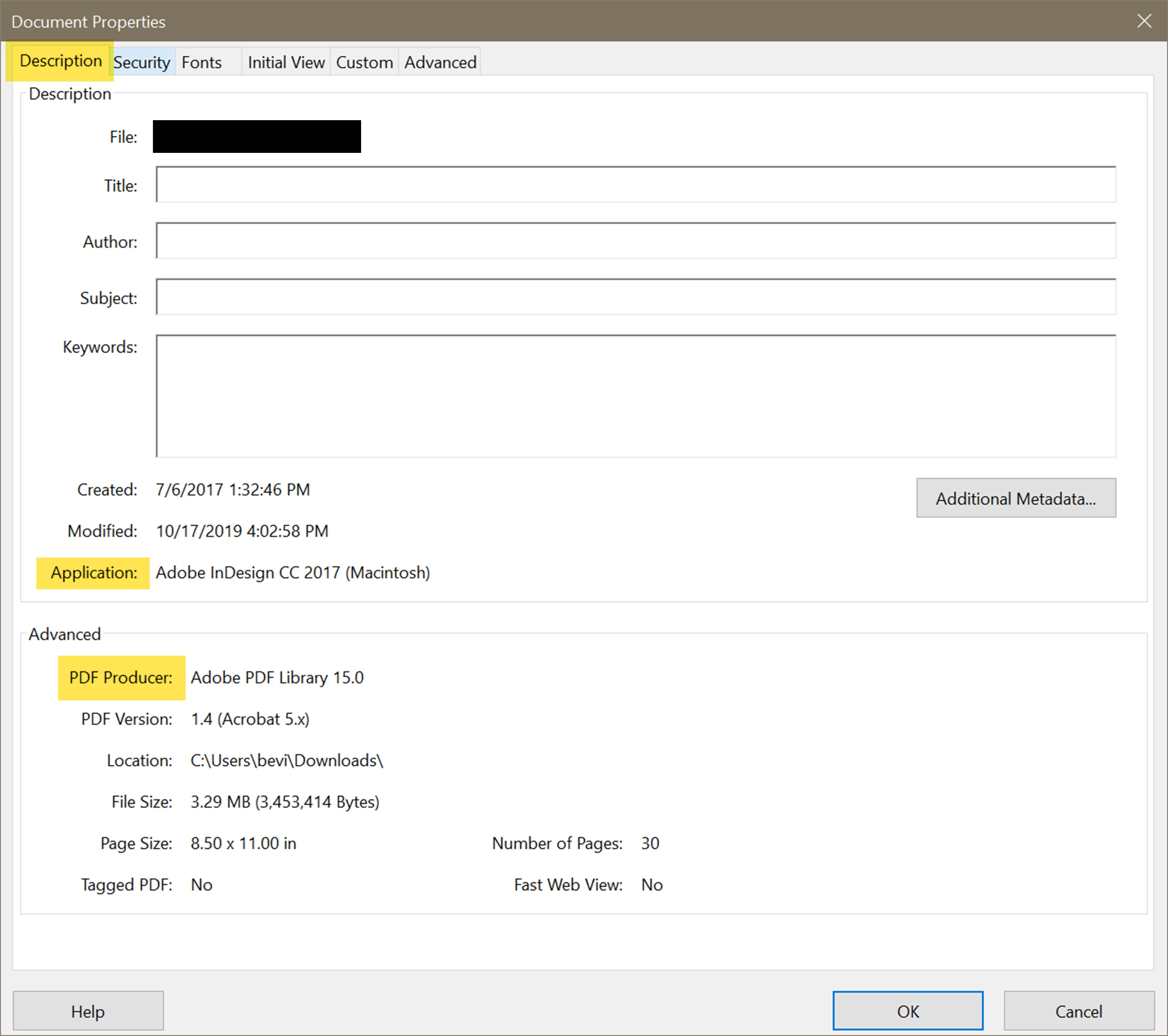

How is the PDF being created from LaTeX? Whenever a PDF is generated from a source document, either a built in software utility or a third-party plug-in/software program is used. These are defined as "PDF Producers" per the ISO 32000 PDF standard and, therefore, they should comply with both the full ISO 32000 standard for all types of PDFs, as well as the ISO 14289 PDF/UA-1 subset standard for accessible PDFs.
You can view what application and producer created the PDF by viewing the PDF's File / Properties / Description tab:
With whatever method you're using, compliance with the standards doesn't appear to be happening. You might need to do one of these steps to create a more compliant, accessible PDF:
