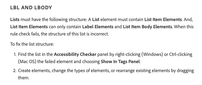

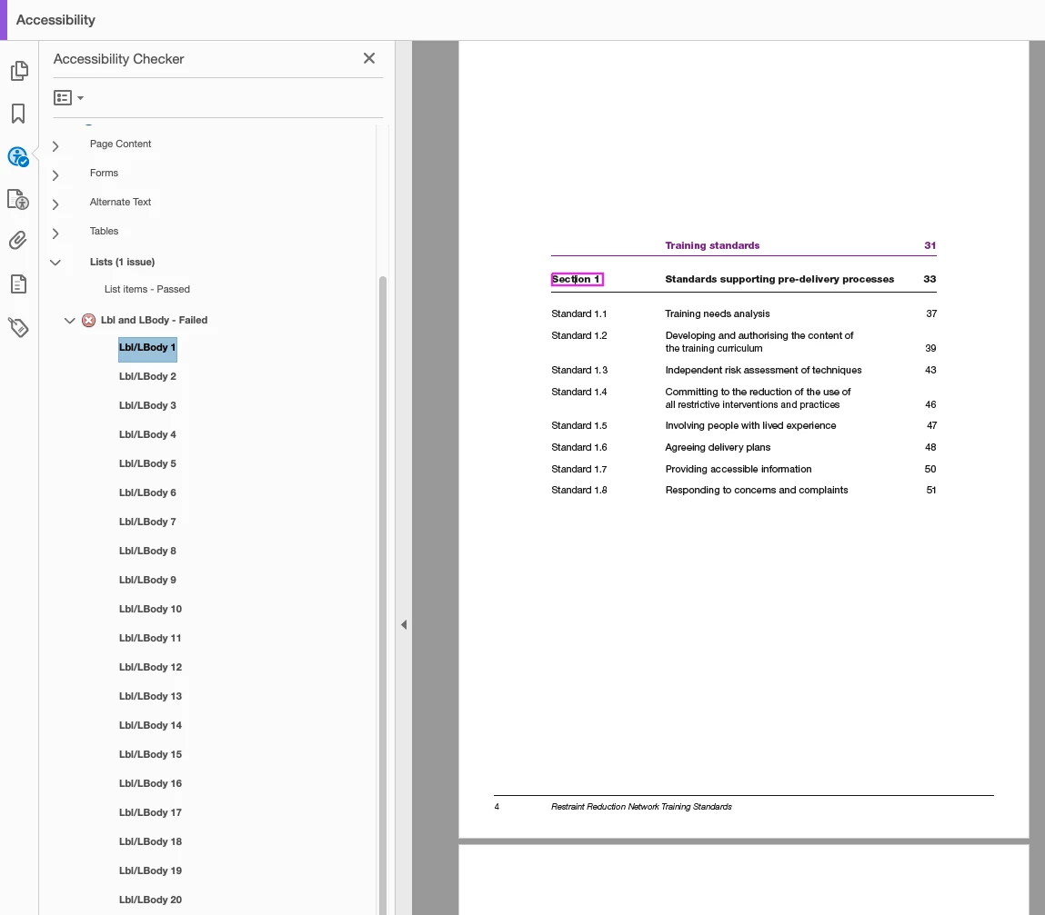

I've run the 'Accessibility Check' in my PDF  document and it's returned 'Lbl/LBody - failed' (see first screenshot).

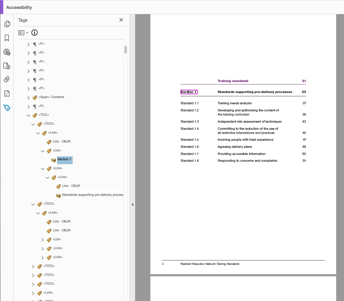

I had a look at the Tags pane (see second screenshot) and the Adobe Help/Support pages (see third screenshot). It suggests to 'Create elements, change the types of elements, or rearrange existing elements by dragging them'. I've no idea how to put this into practice.

@SarahEMcCallWard, what is shown in your screen capture should be tagged as a TOC, as shown in your second screen capture.
It definitely is NOT a list, and therefore shouldn't have <L> / <LI> / <LBody> tags in it.
TOCI elements can have <Lbl> label tags — per the standard — but most (actually, I think it's all but I'm leaving some wiggle room here) assistive technologies don't recognize the <Lbl> at all anywhere, not even in lists, let alone in its other uses in footnotes, TOCs, and anywhere else allowed by the standard.
Therefore, at this time, we don't recommend using <Lbl> in anything other than List structures, which matches what HTML does.
The accessibility checker is flagging it as an error in your current TOC, which doesn't surprise me. Checkers are never in synch with either the standards or the software we must use to create accessible PDFs.
Suggestion: Since the <Lbl> tag is throwing the error in the checker, and since the <Lbl> tag used in something other than lists doesn't do anyone any good, I'd ditch the <Lbl> tag in your TOC. Maybe someday all of this mumbo jumbo will be worked out and all software apps will do things the same way, but right now that's not the case. You have conflicting technologies at play.

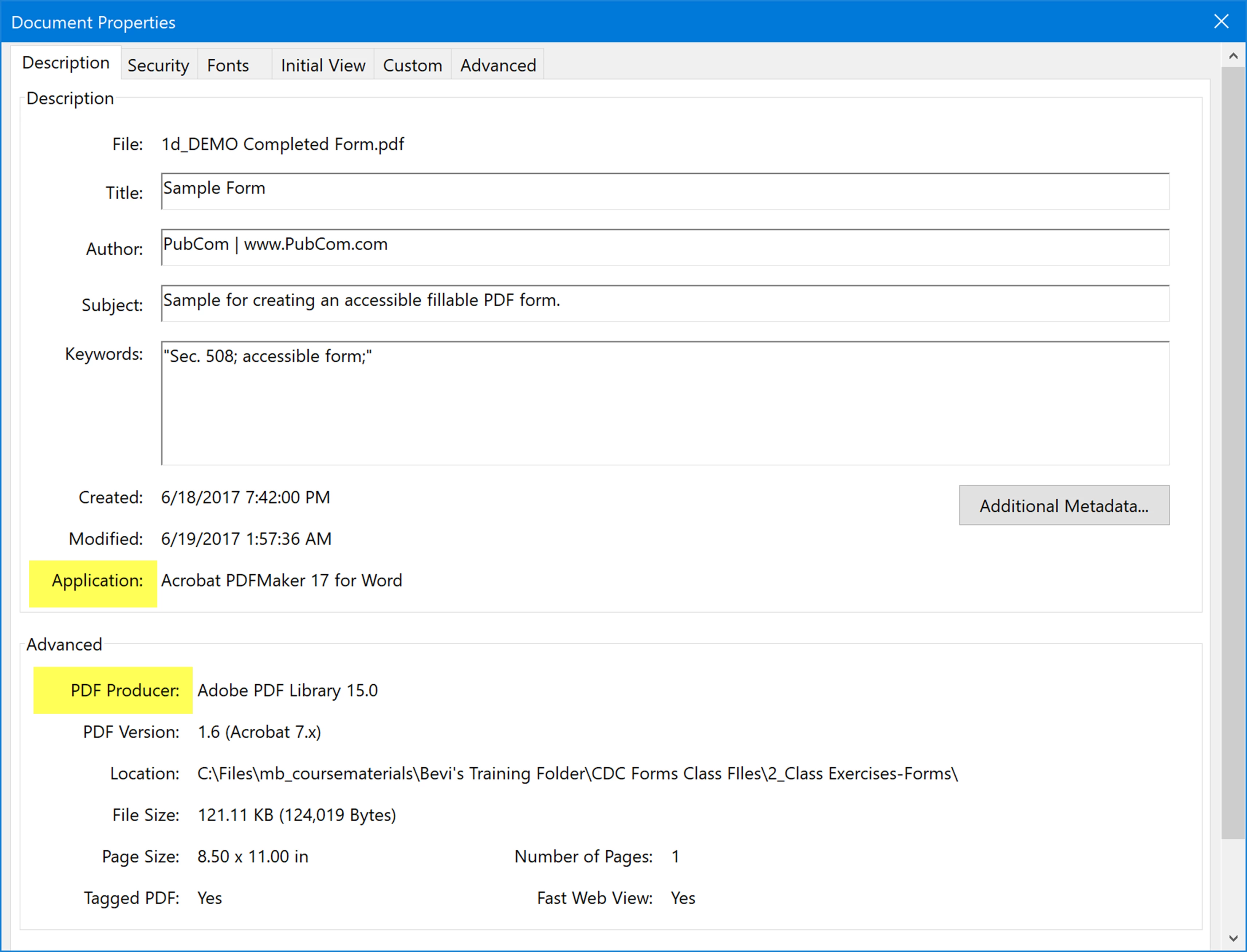

Question for @SarahEMcCallWard: curious, what was the source/authoring program from which the PDF was exported? And which utility was used to create the PDF?  You can find this information in the PDF under File / Properties / Description tab: look for Application and PDF Producer:

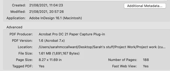

The book was originally created in Adobe InDesign 16.1 on a Mac.
The PDF producer was 'Acrobat Pro DC 21 Paper Capture Plug-in'
The PDF version is 1.6 (Acrobat 7.x)

Let me unpack your answer one part at a time.
Sarah
By @SarahEMcCallWard
Holy cannoli.
How in the world did Adobe Paper Capture get into your workflow? <grin>
That plug-in is used to scan a printed paper document into a PDF, and then run OCR (Optical Character Recognition) on the PDF to turn it into live, editable text.
Worst way to make any kind of PDF, let alone one that's meant to be accessible and tagged. Given that, I'm going to suspect that someone ran Acrobat's Autotag utility in the Accessibility tools panel, and that is the worst way to tag a PDF.
When I first looked at the capture of your tag tree above, I thought "this is a really messed up TOC tag structure like the junk we see Autotag do." Putting in the <Lbl> tag was one clue, the <Link> within a <Link> tag was another (that's just wrong!) and missing <Reference> tag gave another clue.
Question (not to insult you, but needing to understand how this PDF was created in the first place):
When the layout was completed in InDesign...
  1. Did the designer use Indy's TOC utility to create the TOC? Or was it hand typed? If the TOC utility was used, it would have generated a decent or compliant tag tree in the PDF, right out of InDesign as the PDF was exported. You wouldn't be posting in the forum asking what's wrong!
  2. How was the PDF created? If Print to PDF or Export / PDF Press, then that killed all accessibility and would require either autotagging, or OCR + autotagging to make it tagged. And Adobe Paper Capture might need to be used, too.

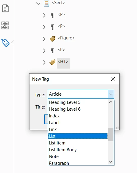

Ordered lists of information can be tagged as follows:
<L>
     <LI>
          <Lbl>
         <Lbody>
<L> stands for list
<LI> stands for list item
<Lbl> and <Lbody> are subelements to <LI> where <Lbl> stands for label, and can be the number, bullet, letter, etc., and <Lbody> stands for list item body and contains the information in the list item.

To create tags, right click on the tag in the same level where your ordered lists are to be created.   Select new tag, and then, choose the right tag type.   See image below.
As shown above, they are list, list item, label and list item body.
