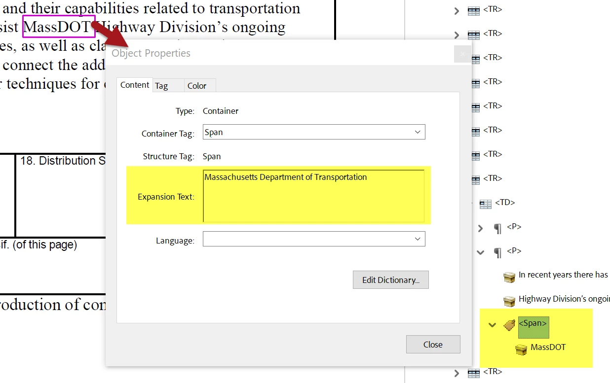

A better, standards-compliant method is to use the Expansion attribute on the acronym.
1. Select the acronym's text.
2. From the Tag Panel's options menu, select Create Tag from Selection and choose the Span tag.
3. In the Tags Panel, locate the new Span tag, right-click, and select Properties.
4. In the Properties dialogue, switch to the Content TAB and spell out the acronym in the Expansion field.

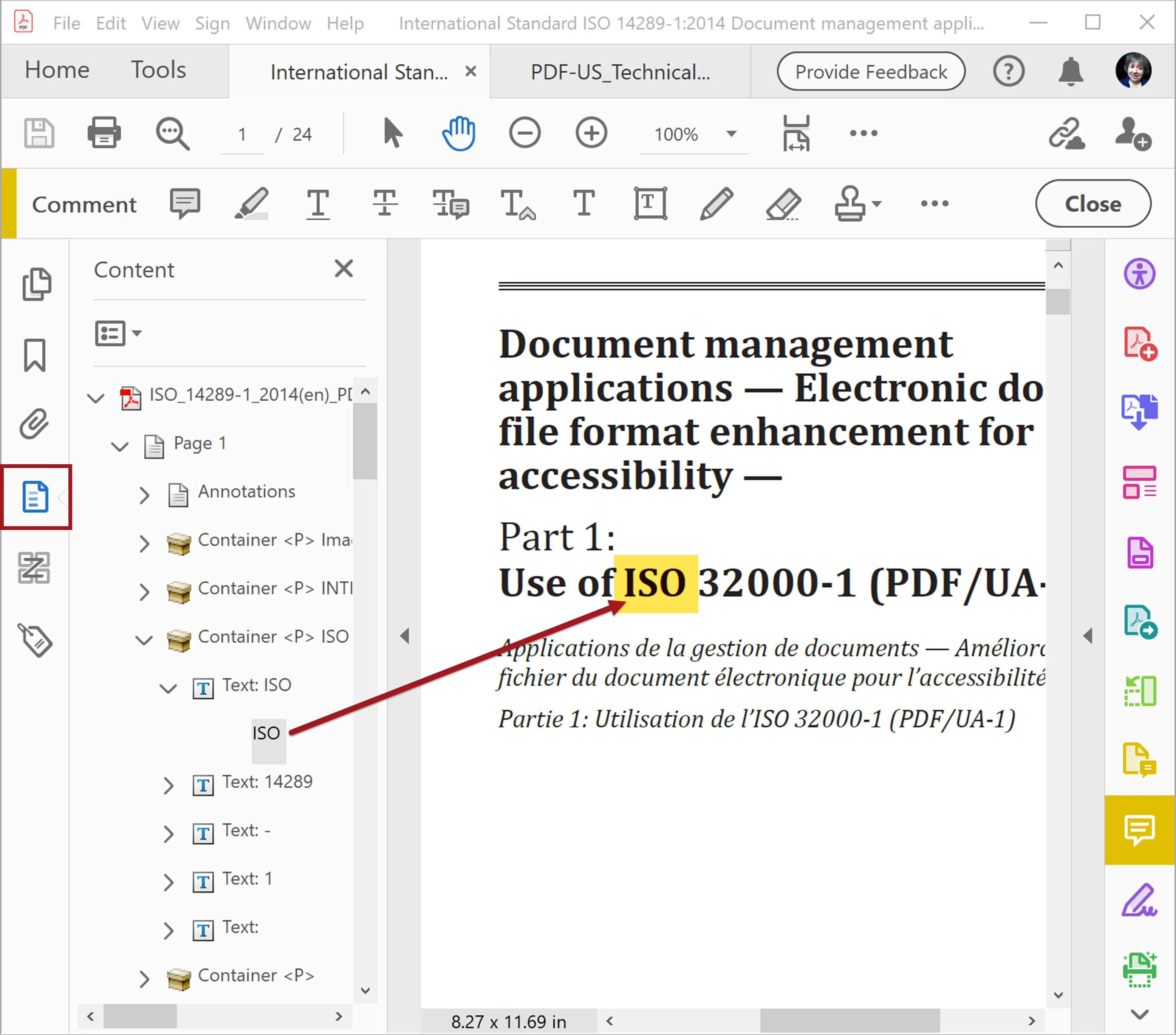

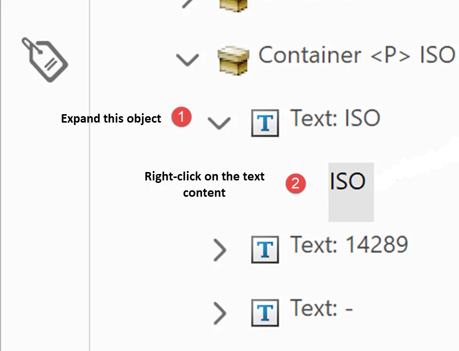

May 19, 2020
Expand the little square box with a Blue T to show the actual text content (1).
Select the text content, right-click, and the Expansion Text field should now be available. (2).
And this is done in the Content panel, not the Tag or Order panel.

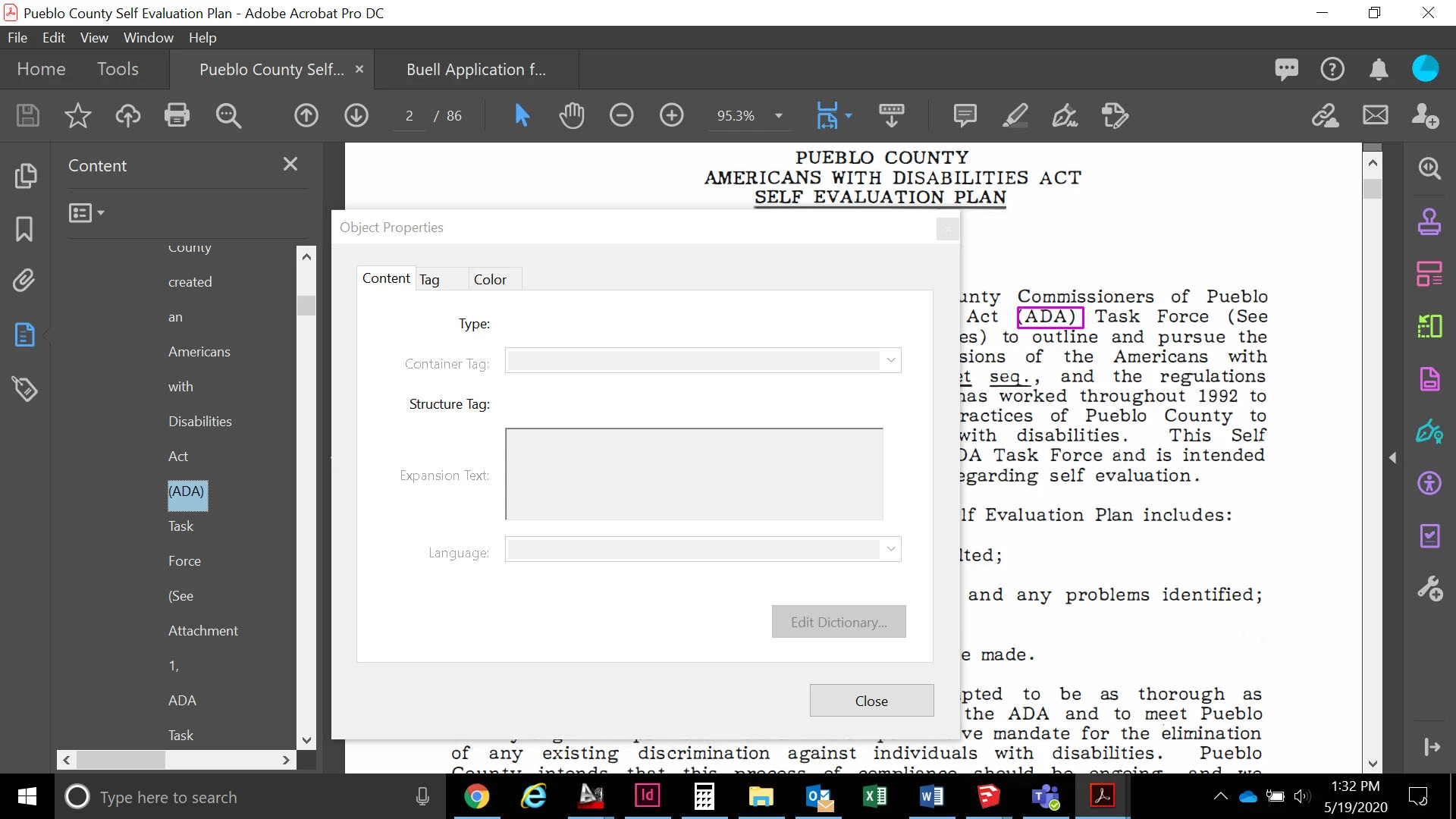

Here is a screenshot of what it looks like when I get to that point. Im also including a link to my google drive. Maybe Im just missing something? ADA Self Eval 1993

Downloaded @wburrer's PDF file and found the following:
  • It was a legacy (printed) document that was scanned, converted to PDF, and OCR (optical character recognition) to provide readable text.
  • It was tagged, but can't determine by which method. Acrobat's Autotag utility? If so, that utility has different results depending on which version of  Acrobat Pro DC was used. Of course, the latest version gives better results. Usually.
  • Found that Page 2 isn't tagged at all. Without tags, the Expansion Text attribute can be typed in. That's why he got a "dead" greyed out field.
Solution:
  1. Tag Page 2 of the document. You can use either the Order Panel's Reading Order Tools (TURO), or run Autotag from the Accessibility panel (right side of the screen).
  2. Then add the Expansion Text on ADA and other text.
  3. Look for other pages that aren't fully tagged (I didn't get the chance to do this for you, but it's likely that if one page was skipped, other pages or partial pages are also untagged somewhere else). You can quickly see this, page by page, by viewing them in the Order Panel. If it's tagged, you'll see the grey content boxes numbered and in the order tree panel.

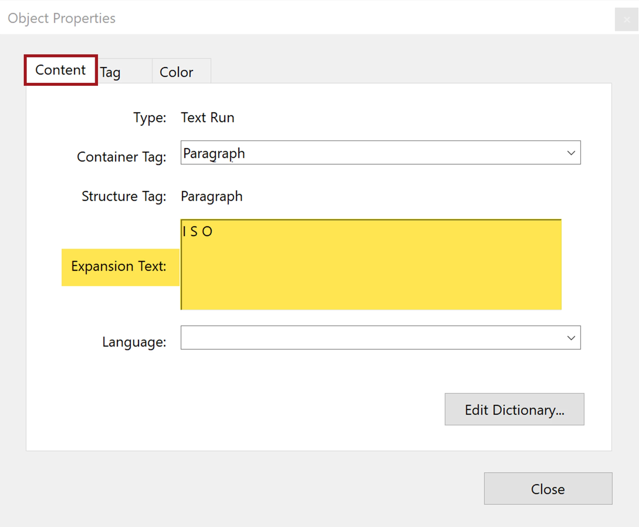

How to set Expansion Text.
  1. Open the Content panel, locate and select the individual letters/words. Expand the Container and Text icon so that you are viewing the actual content characters, as shown below.
  2. With the letters/words selected, right-click and select Properties.
  3. Select the 1st tab Content, fill in the Expansion Text field with appropriate text. For acronyms, we usually spell them out letter-by-letter with spaces in between to force most screen readers to voice it correctly. For some acronyms, we might type it phonetically, such as "eye ess oh."
This is a helpful step to take in a document, but not entirely necessary for each an every instance of the acronym. We generally put expansion text on just the first instance of it in the document, or if it's a larger multi-chapter document, the first instance in each section.

So I tried this, but the expansion text box is gray and Im not allowed to type into it. I used the action wizard to generate the tags, et al, and did not generate this document out of another program line InDesign. Is there any way to allow the use of the expansion text option? I cant find any way to turn it back on.
Thanks
