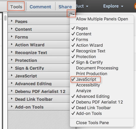

    THanks Karl. View tools javascript worked.  Not  permanent but can turn on when needed
    Karl Heinz  Kremer
    May 17, 2018
    This should be permanent, until you turn it off again.  You can also try to use the tools pane menu:

    I am having the same problem in Adobe Acrobat Pro X.  Under tools it does not show Java script.  I have tried control J and a window pops up but the java script is not showing in the control panel under tools.

    If you are working with acrobat X, then the console is no longer in the menus, but rather on the right under the "tools" section, under "javascripts".
