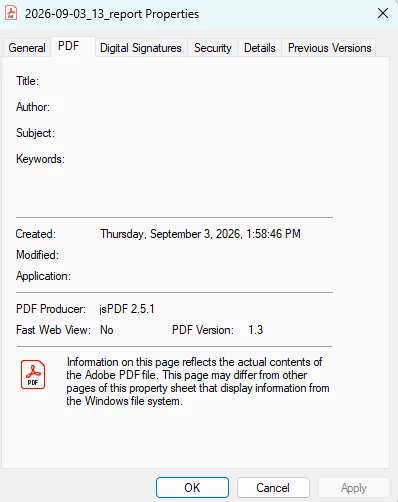

      2.  The problematic PDF came from an external website where I created a report of data. I couldn’t find any issues in the Document Properties. Here is a screenshot:
      3. I checked Creative Cloud and this is the most up to date version of Acrobat, downloaded today (September 3, 2026).
      4. I installed/updated all of the printer drivers and was able to print the PDF without Acrobat freezing.
