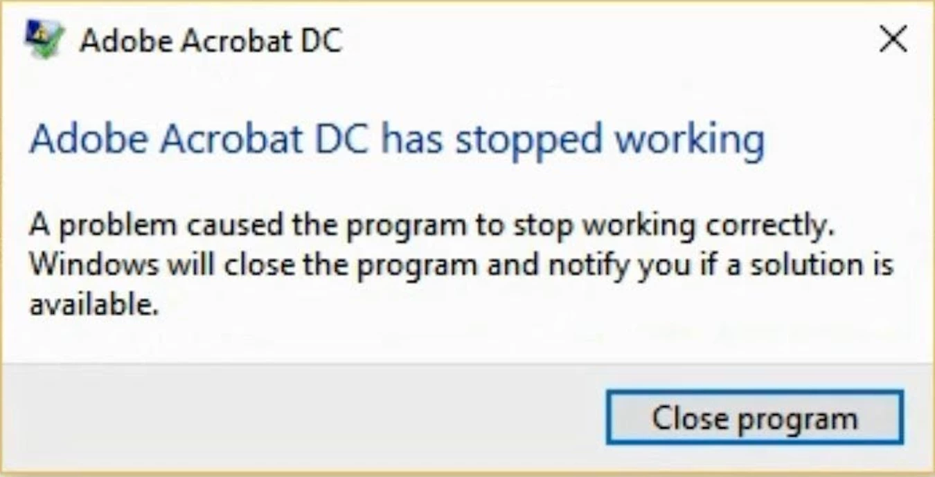

Adobe Employee
February 19, 2018
Once the application quits, do you see the following dialog?
February 19, 2018
@apangasa: I get the same above message; what's the solution?
Adobe Employee
February 20, 2018
When the message appears please do not dismiss the message and follow the steps given below to obtain a crash dump.
1. Start Windows Task Manager. (Press shift+ctrl+Esc to lanch task manager.)
2. Go to the Windows Task Manager window
3. Click to select the Processes tab
4. Select Acrobat.exe from available processes.
5. Right-click to open the context menu, then click to select Create Dump File
Once the dump is generated, you will see the complete path of dump. Please share the dump with me at apangasa@adobe.com
