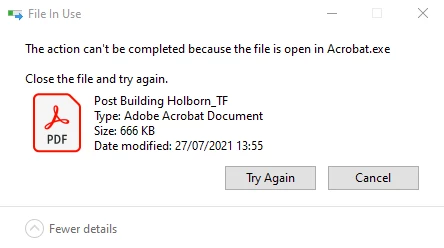

No third party add on to Acrobat, and have tried to uninstall and reinstall Acrobat again with no help. See attached what shows up when I try to move, delete, copy, override the file. And what task manager shows.
