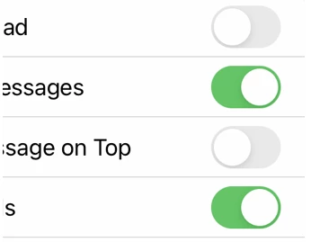

On an Acrobat form, is it possible to create a toggle switch that looks (and behaves) like toggle switches in IOS?
I tried created a button with an icon, but how do I change the "state" appearance according to the action?
Trying to replace radio button groups with this option due to lack of space...

This is possible if PDF is opened in a PDF viewer the supports the JavaScript for changing button icons.
I don't think there is one for IOS. You'll need to test it out.

I don't think they meant they want it to work in iOS, but like it does in iOS (in other applications).

So then, I think they need to know that the appearance of radio buttons and checkboxes cannot the reliably changed (but it can be done). Hence, your image carousel solution, which uses scripts to turn a push button into a 2-state button.
I've done this sort of thing many times, and the one thing I don't  like about it is that it only works in Acrobat and the few other compliant viewers.  I also don't like that the state data is not the value of the field being used.  It is annoying that the list of checkbox appearances is limited.

You can use buttonSetIcon() method in a mouse up action to change the icon.
https://pdfautomationstation.substack.com/p/how-to-build-a-pdf-button-image-carousel
