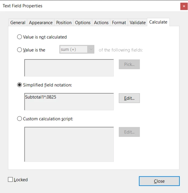

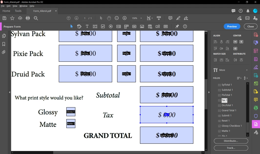

Hi, I'm currently a college student working on a project to create an interactive PDF form using a combination of InDesign and Acrobat.  So far I have everything figured out; however, I'm trying to figure out how to format the invoice form to calculate an 8.25% sales tax rate using the information in a "Subtotal" field (the Subtotal being the sum of 3 other fields).  Unfortunately, I have not found what formula to use to calculate the sales tax.  Attached are what I have so far.  I have used "Subtotal 1*0.0825", "Subtotal1*0.0825", and "Subtotal1*.0825" in both the Simplified field notation and the Custom calculation script sections and am unsure of where I'm going wrong.  Thank you for any help in advanced!

    If you're going to use space characters in the field names, you have to escape them with a backslash when using the simplified field notation option, like this:
    Subtotal\ 1 * 0.0825
    I'd personally remove the space from the field name though. They just cause trouble.

    Thank you for the help!! This worked perfectly.  I'll definitely keep that in mind for future forms.

    Also, be sure to set the field calculation order. If you don't know what this means, post again.
