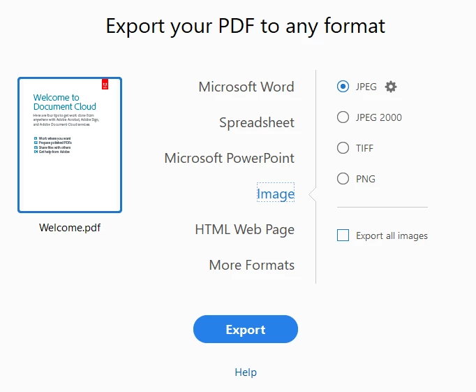

Hi @Evernius,
Hope you are doing well. Sorry for your experience with Acrobat.
We tried reproducing the same at our end, but it worked fine. Would you mind sharing a screen recording of the workflow for better understanding?
This is what we see when trying to export to an image file:
Look forward to hearing from you.
-Souvik.

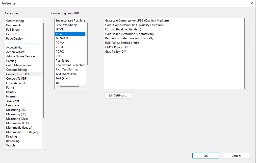

Hi @Evernius,
Thank you for the input.
You may also check the preferences to see if the settings are fine to work for the export (screenshot attached for reference)
Also, it would be great to have a screenshot of what you see when exporting the file as JPEG. If the option is completely missing, try repairing the install once by going to Help-> Repair Installation.
Hope this helps.
