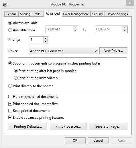

Got it working. Here is the setup in Printer Properties that just printed OK from Word 2010 and CorelDraw X6. Will have to try on other programs:
The change was to make it print AFTER last page spooled. (Deadlock on the default Start Printing Immediately?). Also, this time I checked Enable Advance Printing Features, which I had not tried before. (I had also turned on some IIS features, but cannot see that would have been a factor.)
Am truly glad to get this resolved!
