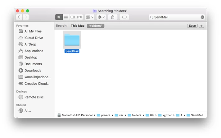

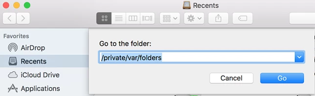

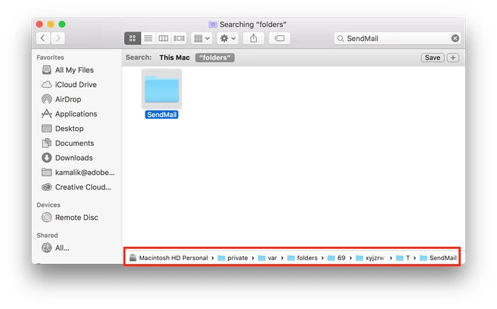

Hello Mac users,
We did some investigation at our end and want to see if a workaround below solves the issue, it works for some users.
Could you please follow the steps below-
Steps:
  1. Quit Acrobat
  2. Open Finder on Mac
  3. Go to the folder: “/private/var/folders/”
   4. In Search section on top right of Finder window type “SendMail” as shown below. Note: Highlight “folders” option in Search bar:
       5. Note the path of this folder as shown below. This should be in /private/var/folders/ and the remaining path will not be constant and is created using hash hence we can’t provide exact path.
       6. Delete this folder.
       7.Launch Acrobat and try the workflow where you are facing the issue.
Let us know if this resolves the issue.
Arvind

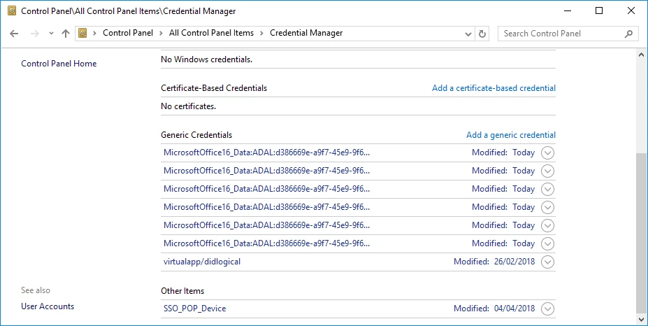

Note: I know this is a Mac thread but on your Mac you might be able to get this to work. I came across this today at work and we run Windows 10 and Office365.
After a bit of fault finding I went into Control Panel - Credential Manager - Windows Credentials - Generic Credentials, and cleared all the MicrosoftOffice16 passwords.
Then went back to my .pdf - "Send File - Attach to email" and it did pop up a window asking for my Windows Credentials which i entered, and it has worked fine since. Not sure why but Acrobat has not frozen since deleting and re-entering my domain password.
Maybe if you clear an Adobe or Office password from your Keychain it may work.
