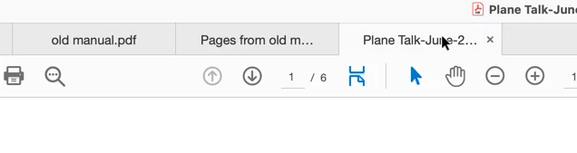

OK, in this first screen shot you can see my cursor on the tab.

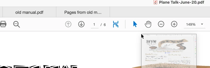

Here you can see my dragging that tab downward.

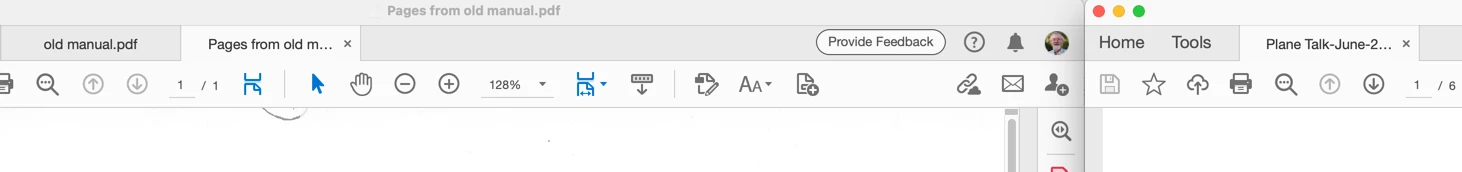

And here you can see the two documents side-by-side.
Does that help?
Does that help?
