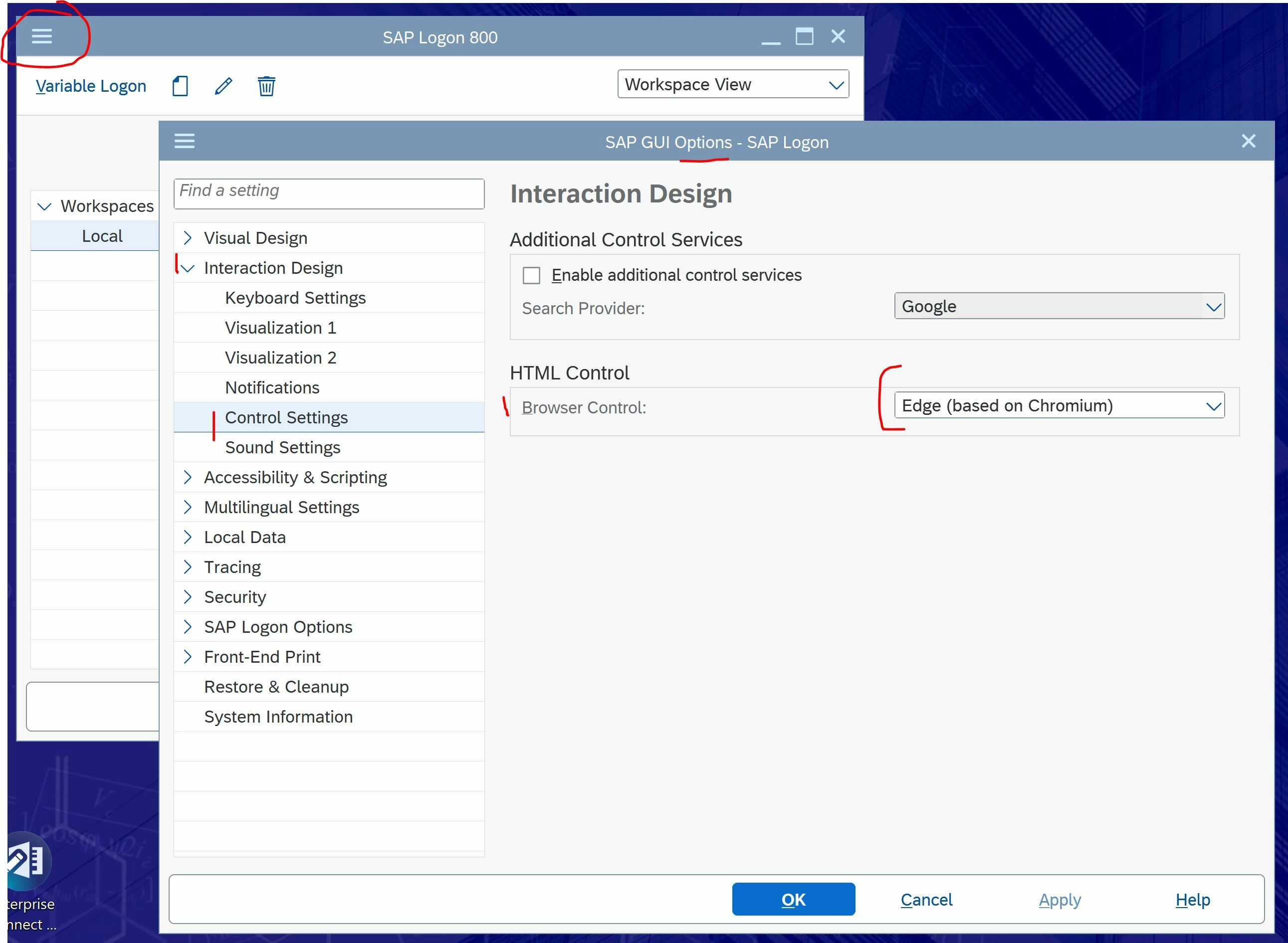

To set Edge as the default "Browser Control" :
1-Execute SAP Logon
2-Click on the top-left menu (or hamburger menu), then select Option. Pull down the " Interaction design " menu. In the "Control settings" section, select "Edge (Chronium-based)".
3-Connect to SAP.
Debug & solutions :
option 1: Edge configuration on SAP 7.4/7.9
option 2: upgrade to SAP 8.0 (Edge is natively configured by default)
1-Execute SAP Logon
3-Connect to SAP.
Debug & solutions :
