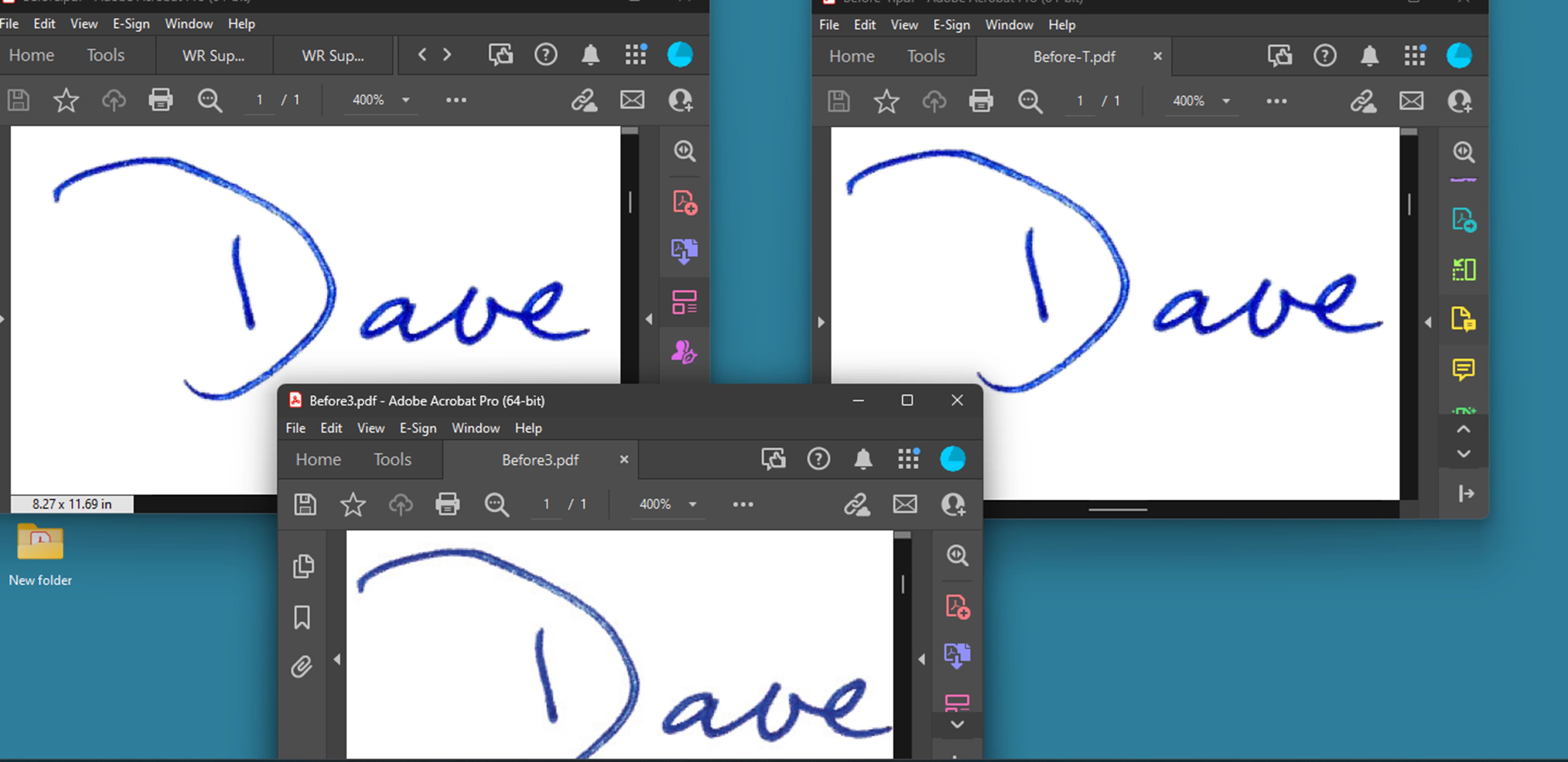

In my screenshot below the image to the left (from top to bottom) is your original file "Before" (with the stamp signature). The image to the right is the exported file "Before" to a .tiff image file.
The image at the bottom, is using a manually-modified version of Press Quality presets and other configurations that I had to combine, which are available at the virtual printer level.
With this method, you can (and may may avhieve) a desired result.
