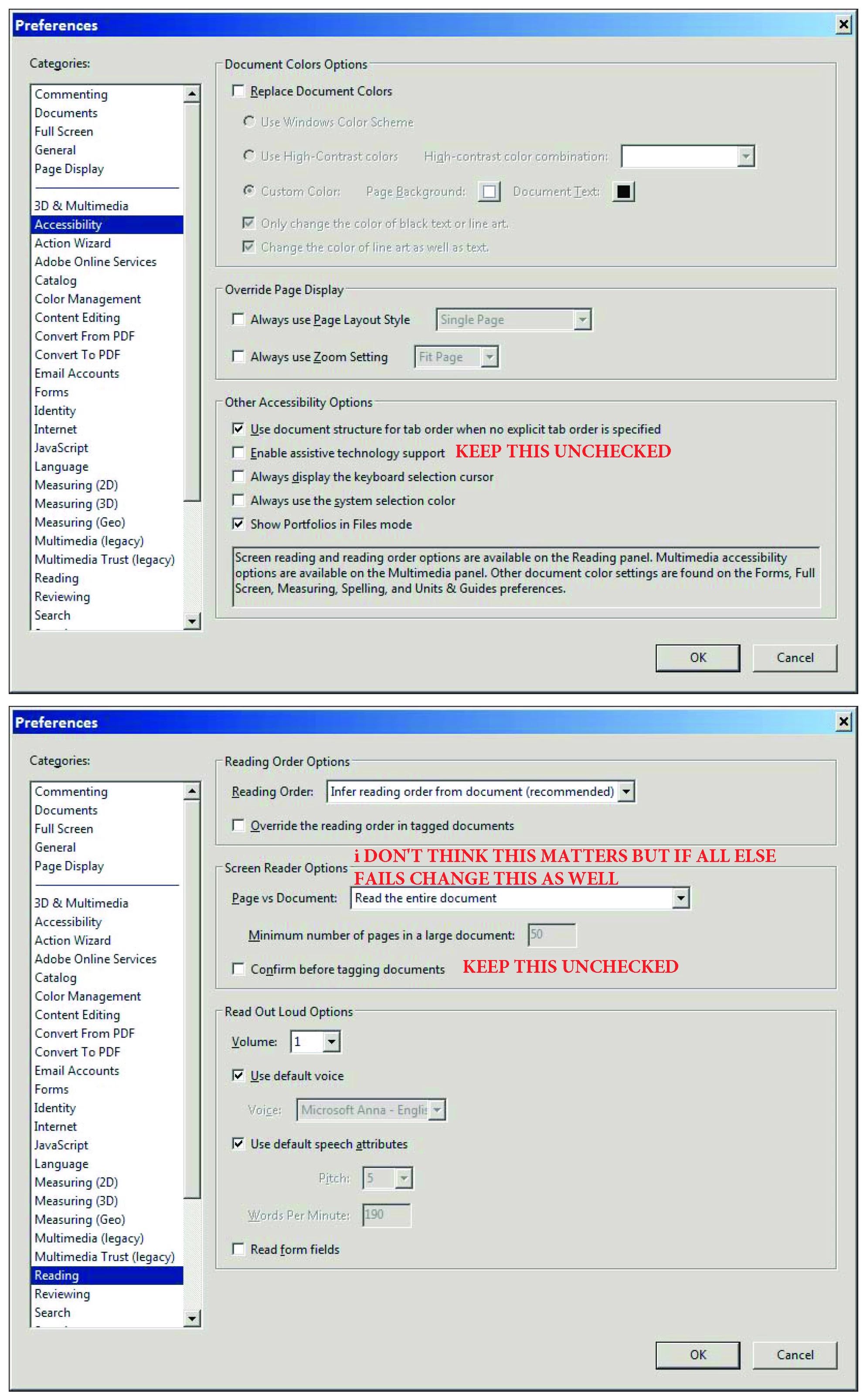

Had the same issue after recent Acrobat update for Mac.
Solution: Go to Preferences > Accessibility. Then turn off "Enable assisted technology support".

I am using Acrobat Reader DC version 2015.017.20053.  This works for DC and I have been able to recreate the problem.

My Solution: This problem has plagued me on and off for years .  Fiddling with screen reader options does nothing . I solved this problem (for now) by going into preferences/accessibility and unchecking "enable assistive technology support."  I even went back into screen reader options and changed it to "Read the entire document" instead of read current page only and the problem remains solved for now.  Unfortunately this may not be a long term fix because when I reversed the settings, I am unable to duplicate the problem. .  I have also uploaded a copy of my preferences if it helps.

I am able to duplicate the problem if I set Preferences -> Reading -> Screen Reader Options -> Page vs Document to "Read the entire document", and uncheck "Confirm before tagging documents". If I check "Confirm before tagging documents" and change Page vs Document to "Only read the currently visible pages", the problem goes away. Please post to let me know if this works for you.

Turn off autoreading in the preferences.

Try checking View > Read Out Loud > Deactivate Read Out Loud; or the keyboard shortcut Shift + CTRL + Y
