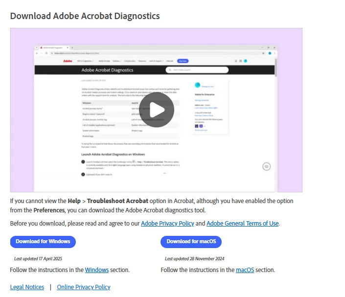

    There is no menu item anywhere in Acrobat Reader 2026.002.21869 to enable Troubleshooting for collecting Acrobat Diagnostics.
    Let me know if you need further information to fix this bug.

    Anand Sri Bhattacharya
    Sep 3, 2026 5:31 PM UTC
    Hello ​@datro
    I hope you are doing well, and thanks for sharing all the details. Sorry for the trouble.
    To collect the logs, please download the log collector tool, which is available at the bottom of the page: https://helpx.adobe.com/acrobat/kb/acrobat-diagnostics.html
    Please reproduce the issue, collect the logs and share them with us for further investigation.
    Please reach out if you experience any issues while collecting the logs.
