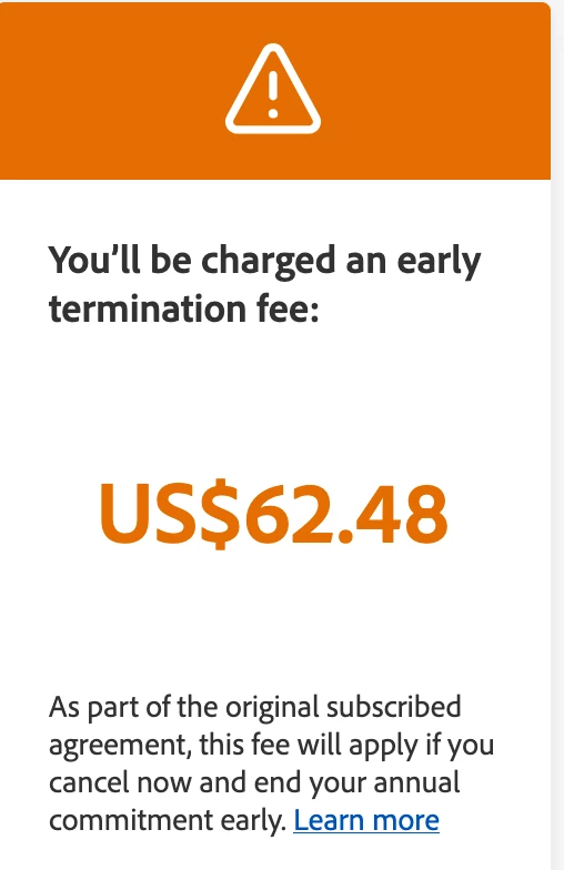

    I opened a case and Adobe closed it without resolving anything:
    “Your Adobe Customer Care case number ADB-47062463-P4Q6 is closed.”
    That’s sucky customer service.  I’m going to unsubscribe since they don’t want to support their product.
