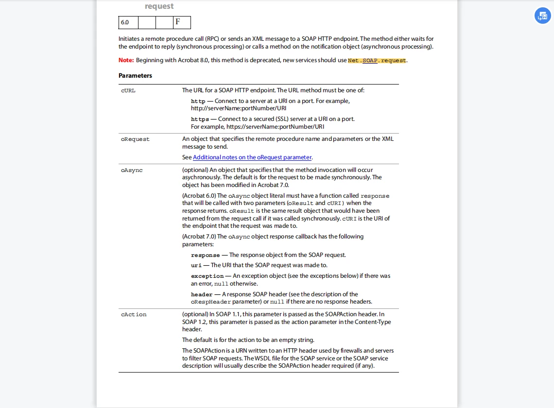

I opened the PDF file containing acrobat JavaScript in acrobat render
About the script of network request, I can't send the request
In this file, I use the soap protocol to communicate
This network script can be accessed normally in acrobat DC advanced version
Relevant settings are posted below for permission settings for scripts
Please answer my questions
belive:
netWork:
if,my setting is error,pleace tell me

I gave the answer. The old product LiveCycle was renamed as Adobe Experience Manager (AEM). The product does many things. One small part if AEM is used to add "rights" to a PDF. You install AEM on a server, and use it add these rights. The end user does not need to install anything except Acrobat Reader. The idea is that this is a valuable feature, you must pay for it. Usually buying Acrobat for each user is most cost effective unless you have many hundreds of users. The price of AEM is "by negotation". So I repeat: SOAP requires special rights for which you need AEM (5-6 figure cost).
AEM product page: Incorporate CMS Software Into Your Brand | Adobe for Business | United Kingdom
AEM documentation: Adobe Experience Manager Documentation
AEM is complicated, and we know nothing about it. But here is a page in the documentation talking about the kinds of rights you can add for Reader: Certificate types used by Acrobat Reader DC extensions | Adobe Experience Manager

You need to check the JavaScript documentation for every method you use, to see if it works with Reader. The "quick bar" gives this information. SOAP requires special rights for which you need AEM (5-6 figure cost). It is often more cost effective to just buy Acrobat subscriptions for each user. Soap and Acrobat Reader 9 | Adobe Acrobat (acrobatusers.com)

I made a mistake when I asked
The problem is soap
Version adaptation does not occur on soap methods
It requires only form permissions, and my acrobat version is the latest
I didn't understand what you said about the cost
But I can't pay for each of my users
The information you provided me is too old

For the form permissions you need special rights at the document.
July 1, 2022
I trigger an error display through a script that does not send a request
The console cannot be seen due to the render environment
I wonder if you understand my situation
