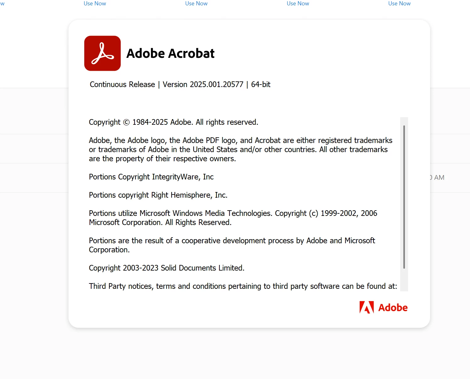

Thanks for the reply. I followed your instructions and below is the screenshot of the About Adobe Acrobat pop-up window. Acrobat Standard was installed again, and not Pro. Any help you could give me would be great.

Hi @Qantas22590038w9pt,
Thanks for the response.
With the recent releases, Acrobat has moved to a unified naming system, where the application name does not have any differentiating specifics.
To confirm if the application version you have installed is Acrobat Pro or Standard, you can launch Acrobat > open any document > go to All Tools > click See More > scroll down > and you should be able to see your entitlement.
Hope this helps.
