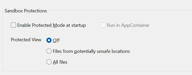

  • Navigate to Acrobat>Preferences (Ctrl+k)>Security (Enhanced)>disable "Protected Mode at Start-up", "Protected View" and "Enhanced Security">OK>close and reopen Acrobat. [Windows only]
Note: these changes are only for testing purposes. Once tested, please change it back to the previous setting.

Try elinminating the Protected mode in the Security Settings under EDIT-PREFERENCES
