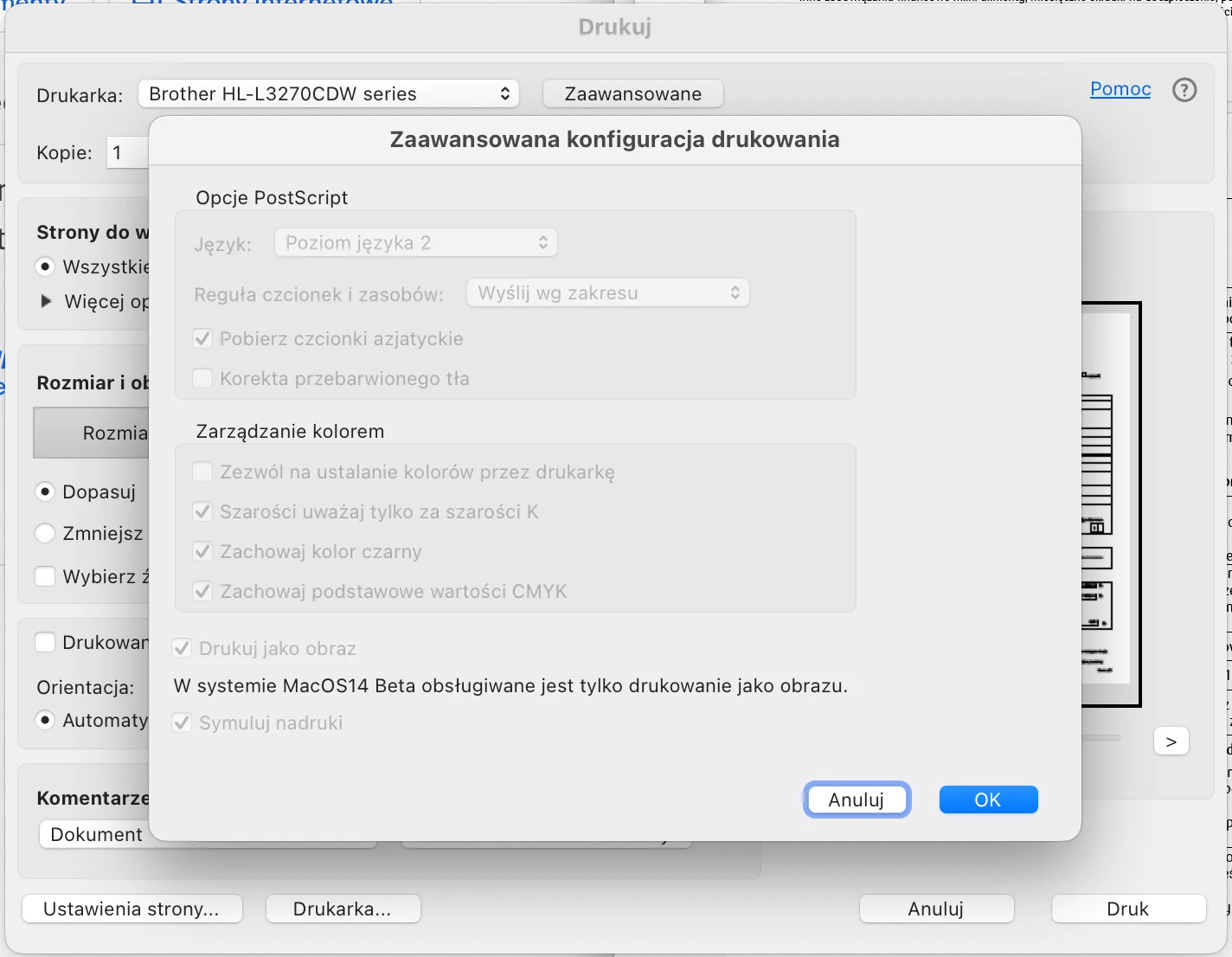

February 7, 2024
Unfortunately, subsequent updates did not change anything for the better.
For me, printing to an image is disabled and I cannot change it because AR informs me that in MacOS14 Beta (Sonoma) it is not possible to print other than to an image.
The problem is that I don't have the Beta version... but the current version of Sonoma 14.3 and the latest AR version!
What should I do? Help!
No tips found here so far, still don't work!

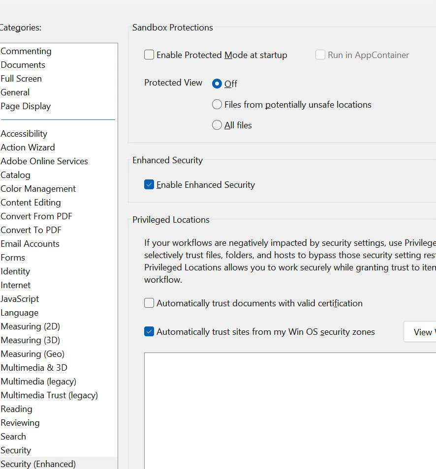

mariahweyne
October 13, 2023
Try these settings.

Only way to print the documents is opening the "advanced" menu in the print dialog and select "print as image"...
