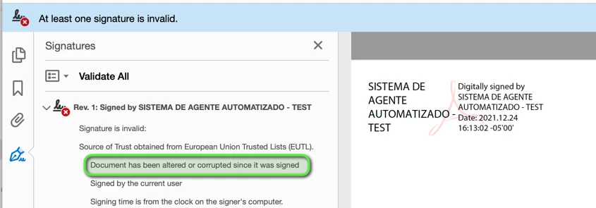

Reproducing the problem is easy:
  1. First, disable “Include signature’s revocation status” from the Signature Creation and Appearance Preferences.
  2. Then sign with any certificate the attached PDF.
  3. And finally “Add Verification Information” for this signature.
With a result like the following:
Now, the particularity of the attached PDF is that it includes an attachment with its file specification dictionary (/Filespec) added to the Names entry as a direct object:

I doublechecked your example. Indeed, after signing your file applying any additional incremental update to it does break the signature. On the other hand, if one patches your file and refactors the direct file specification dictionary into an indirect object, applying incremental updates after signing does not break the signature as long as the updates contain only allowed changes.
Also I couldn't find anything in the PDF specs requiring file specification dictionaries in name tree values to be indirect.
I also think, therefore, that this is an Acrobat bug.
Acrobat's general behavior in this context - positively validating signatures in PDFs with certain small errors without warning as long as the signature covers the whole file but then suddenly negatively validating them after applying any incremental update, even if  it containing only allowed changes - is questionable anyways. But the same behavior in case of your file without such an error is extreme.
