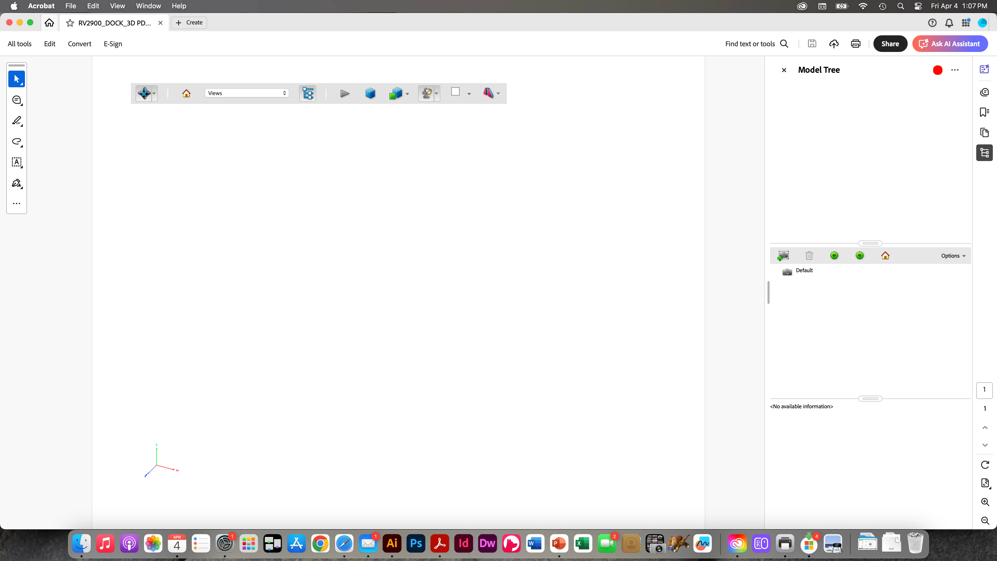

Adobe Acrobat 3D pdfs will no longer display
Adobe Acrobat Pro 2025 will open a 3D pdf but the screen displays blank and the model tree is blank.  This applies to 3D pdfs that have been previously opened and those that are new files. The previously opened files do not display previously saved views or the default view.
Running on a Macbook M4 Pro, MacOS Sequoia 15.4
I have tried uninstalling and reinstalling Acrobat two times. And yes, restarting the computer.

And now  the display looks like the screen shot I attached below. it is a 56 MB size file and that is the blank screen I see.
Do to client confidentialy I can not share the 3D pdf I work with.
Acrobat Version 25.1  (2025.001.20438/Unified App)
I had previously tried your recommendations for 3D multimedia and rendering settings. Program crashes when closing if on OpenGL.  Report sent to Adobe and says "no fix"
