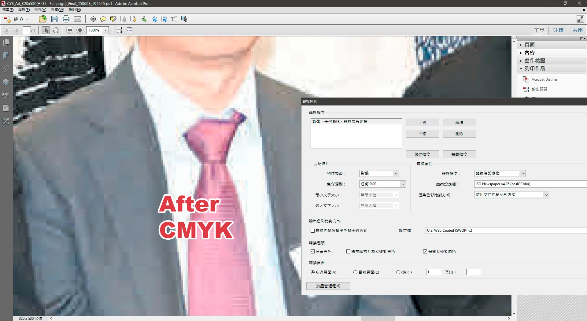

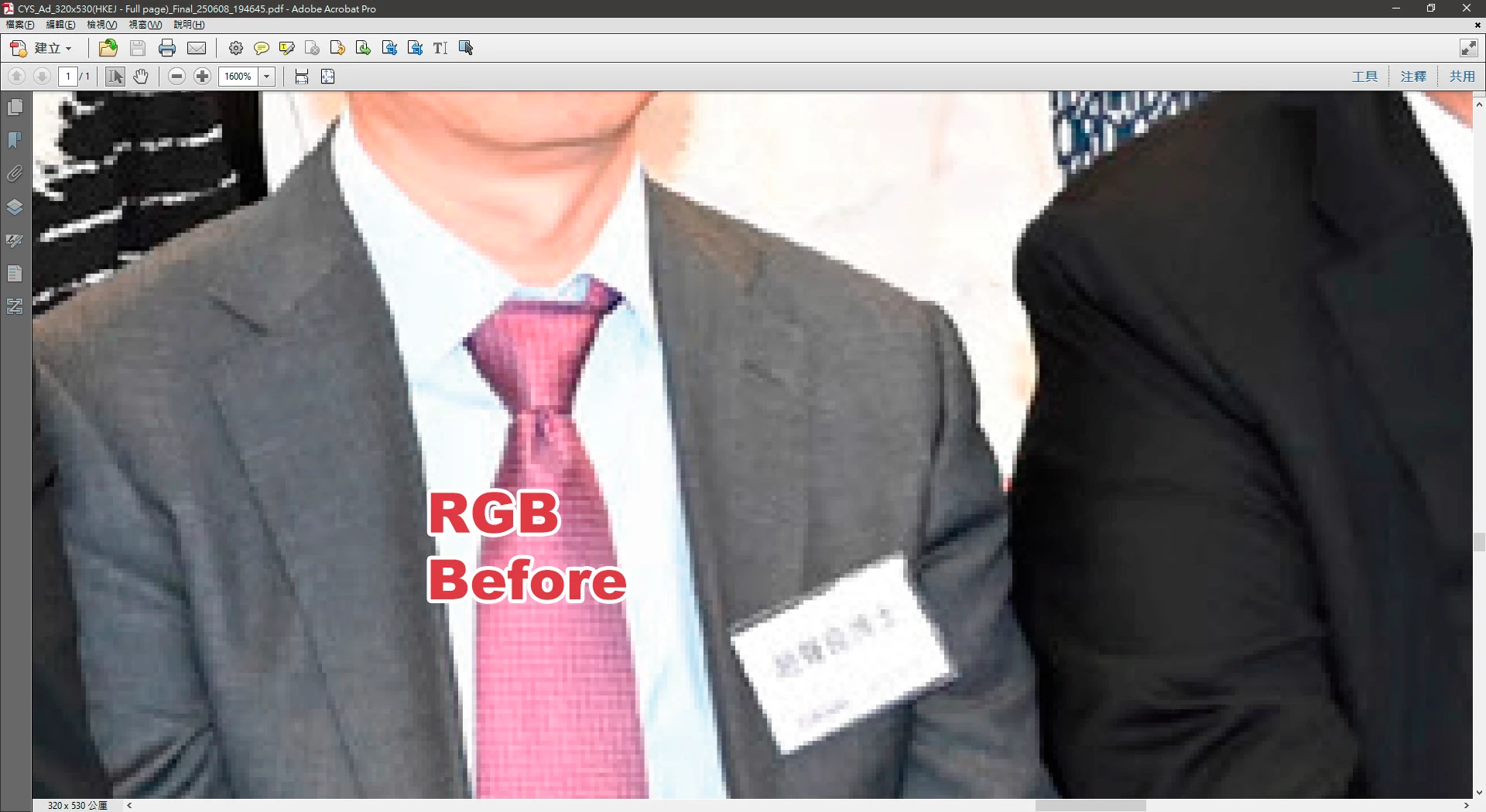

i use the color conversion in acrobat, in result all the photo will loss detail, like a high compression JPG file, have many noise, can i solve this? or is any wrong setting?

No, it same
But, I think it is because the source file have some problem,
when I creat a new file (just a photo) in pdf , and use this function have no problem,
But, when use some file from client, it will be problem,
I try it,  link the client file in illustrator, and Embed it, save as pdf file to change it color, have same problem,

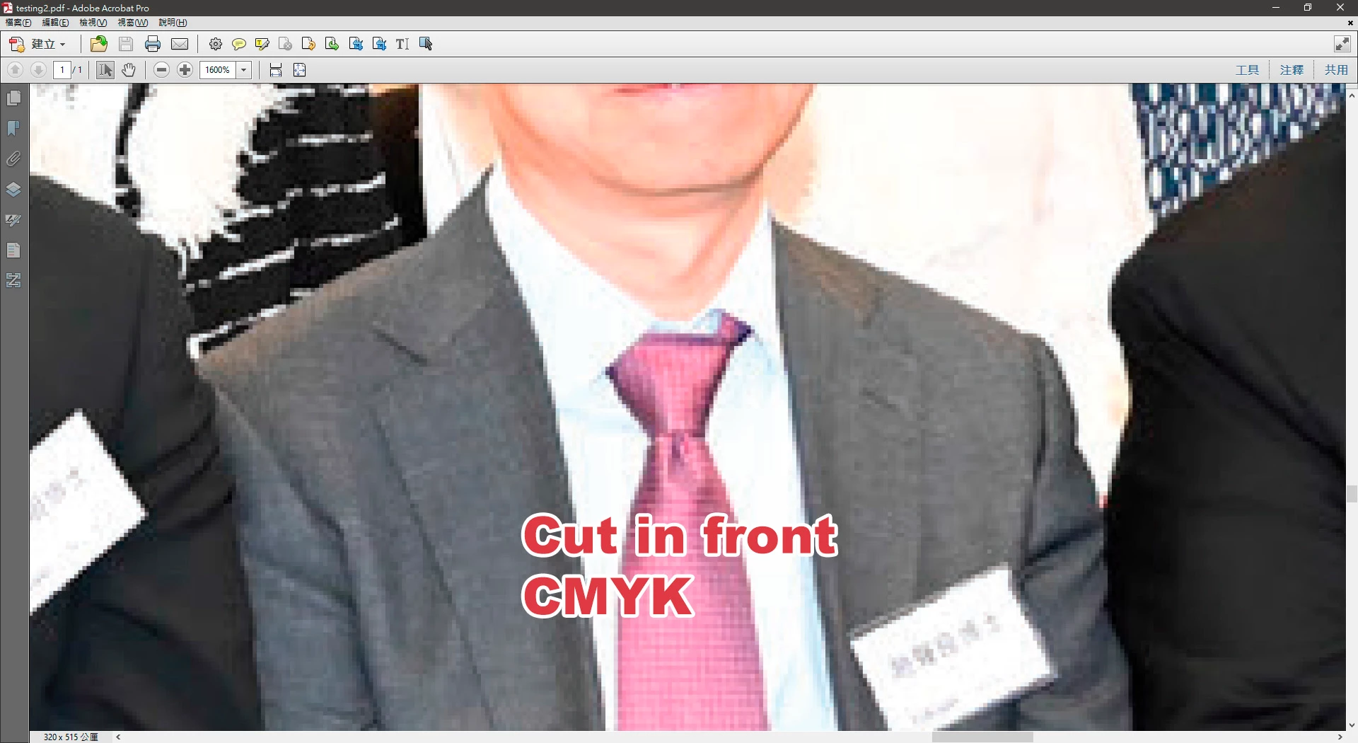

But when I select a photo in this file and cut it and paste in front, save as pdf, use arcobat change the color, this photo have no problem but other have same problem.
Or use arocobat color management setting save as postscript file, to change it will no problem.
Or link in  illustrator save as pdf, when save pdf select convert to cmyk, that will no problem.
In real, most client file have this problem (in my job).
