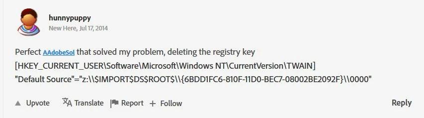

Digging through more posts in this forum, I found the solution. It is at Acrobat XI won't recognize scanner
It required deleting a registry key.
