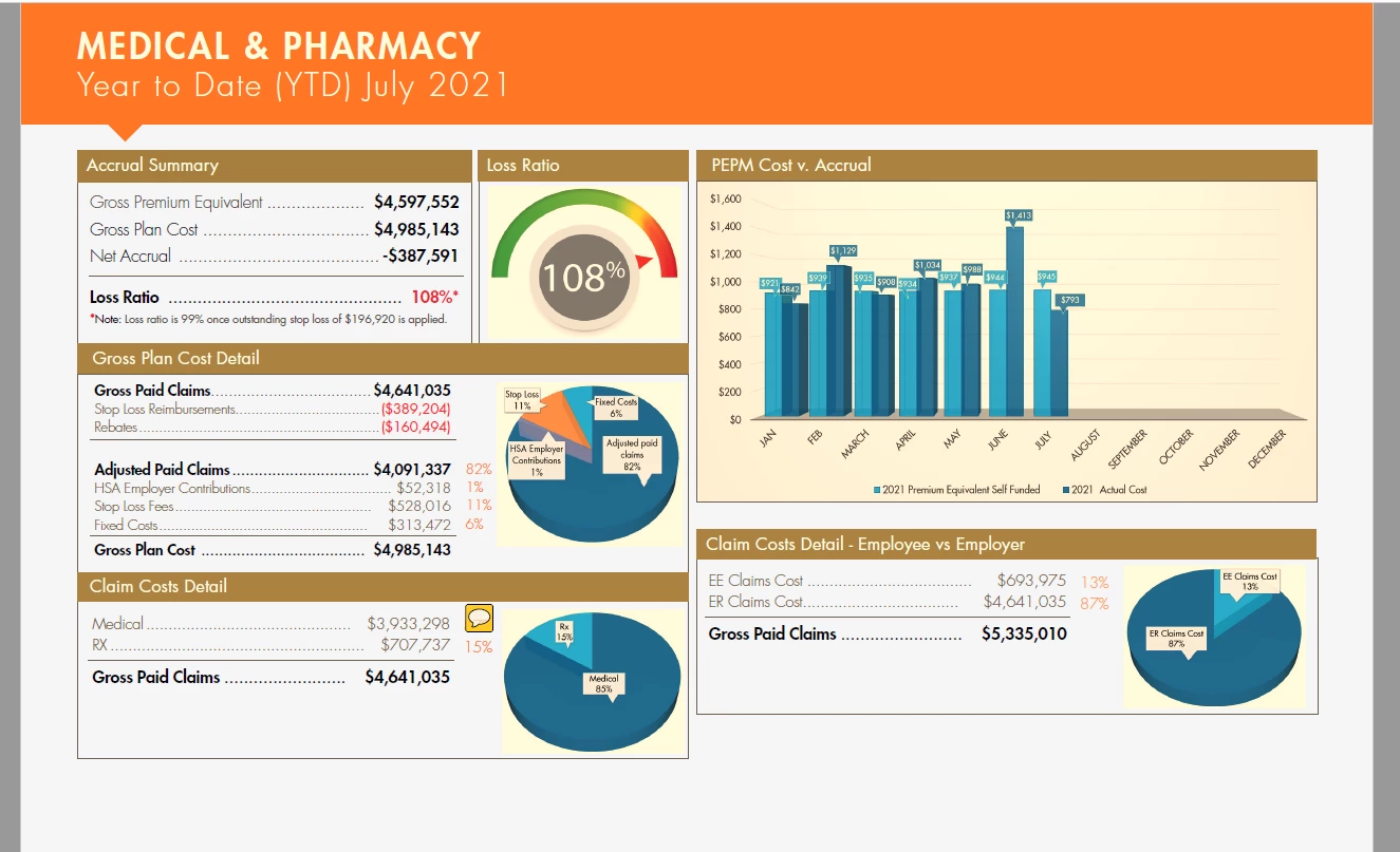

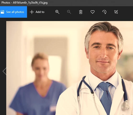

Using the suggested fix does not work.  It only changes the background color of the document not white text or white colors used within images:
This never used to happen it only started happening recently after a recent update.  This might also be a windows issue as the "photos" app also displays white within images as this tawny yellow as well.

This may not be an adobe update issue but a windows update issue as I've also noticed certain windows apps like the the "photos" app display white within text/imagery as that tawny pale yellow.
