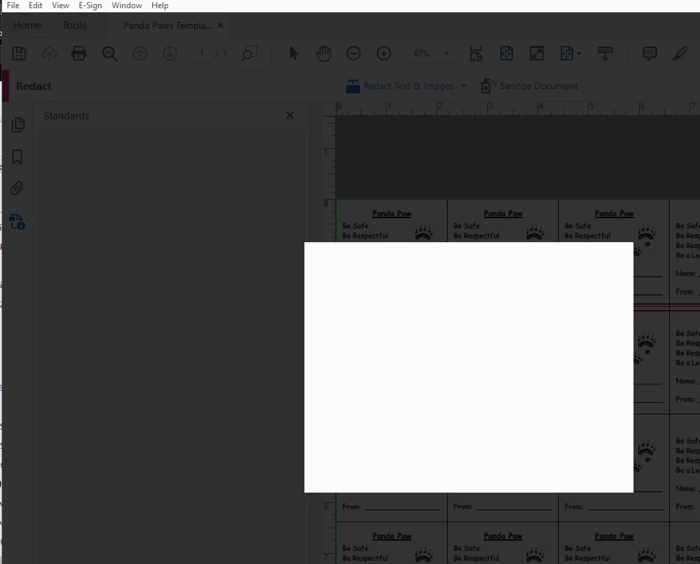

I continually have a problem with Adobe Acrobat Pro DC when I try to use the redaction tool.
  • I select the text I want to redact
  • I click 'Apply'
  • The pop-up which should appear (confirming redaction, etc.) appears as a blank box, and the entire programme basically freezes. I can do nothing else, except open my computer's Task Manager and click 'End Task' for Adobe Acrobat.
    (See attached image.)
This is a huge problem, since my role as an employee and my unit's function requires the ability to fully and securely redact on a daily basis.
I am using Adobe Acrobat Pro DC - Version 2021.005.20048
Can anyone help?

I'm encountering the identical issue. When I click apply, a blank white box pops up and the entire system freezes. The only way out is through Task Manager and End Task. I've been using the redaction tool without any issues before, but now I'm facing the same problem as others have described in their posts. I've attempted the suggested remedies, but none have worked. Adobe, it's crucial to address and resolve all these bugs promptly!
February 8, 2024
Issue has been confirmed by Adobe as a corrupt registry entry that relates to AcroCEF.exe
Resolution is to delete the key:
HKEY_LOCAL_MACHINE\SOFTWARE\Microsoft\Windows NT\CurrentVersion\Image File Execution Options\AcroCEF.exe
Delete all sub keys as well
Fixed!
