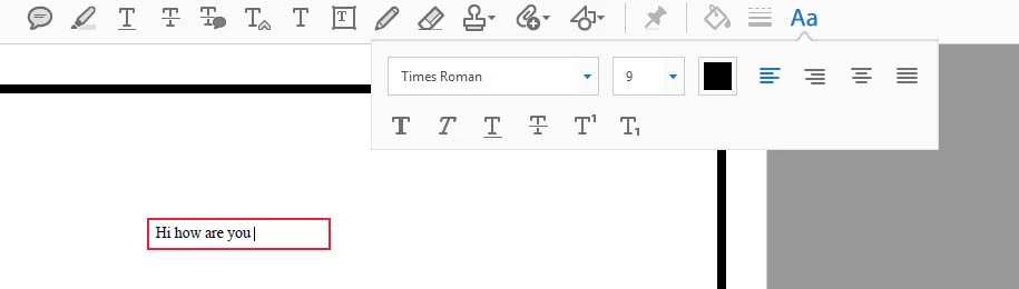

Hi nicolawhiteley23 ,
Sorry for the inconvenience.
This is a known issue and we are working on it .
Until then you can use the new text properties.
Highlight the text which is in the text box in the document and press CTRL+E or click "Aa" option from the menu bar after selecting the text.
Let us know if this works .
Regards
Sarojini
July 19, 2016
Hi Sarojini,
Highlighting the text and then pressing CTRL+E does not work but using the Aa option does, I had forgotten about this but hadn't added it to my custom toolbar as I always use the properties instead. Thank you for your help, however please could you let me know when there is a fix for this - looking at previous threads it seems to have been going on for many years!
Nicola
UPDATE: Sarojini.Nagar, I have changed the font size and colour of text in a text box using the Aa option and want to make these choices default, but right-clicking and selecting 'Make Current Properties Default' isn't working. Can you advise how I can do this please? Many thanks.
Sarojini_Nagar
July 19, 2016
We will let you know when we receive an update about the fix.
With regard to your other query , please try right clicking in a text box and select the "Properties" option and check the box which reads " Make properties default" and click OK .
Let us know if this helps .
Regards
