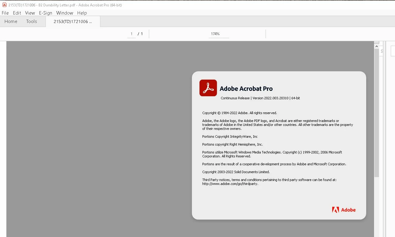

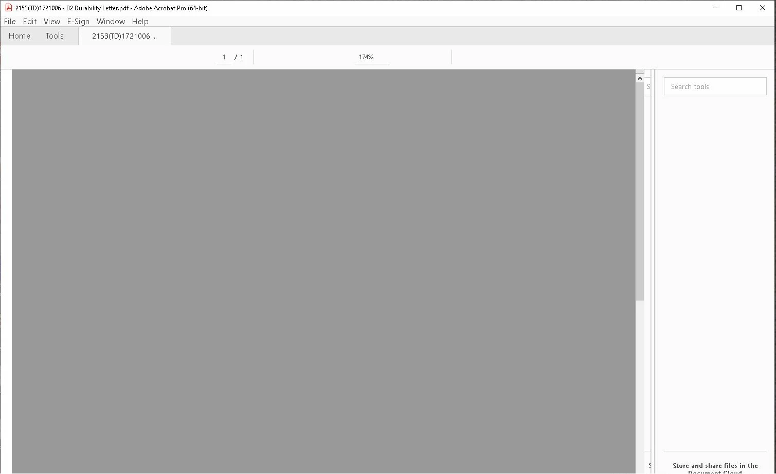

Hi all,
First timer here. Need help with an issue regarding Adobe Acrobat Pro version.
I have a user whose Adobe Pro is not displaying the content properly.
He has a Pro license assigned to him and can edit/combine/export and use all other Pro features when using the browser version online.
But when we install the desktop app from Creative Cloud, it does not display the content. All the tools on the right hand side are not showing nor are the toolbar options.
Same happens if we install Adobe Pro from Adobe's website without going through CC.
When I click on View and then Preferences, nothing is popping up as well.
I ran the app as an admin, same thing happens.
We have 3 users who are having this issue now.
Also, after installing it from CC, I ran Repair installation and then it said that there is an update available and it installed the update and then kept giving "An error has occured" and that error doesn't go away no matter how many times you click on Ok.
In the meantime, I have installed Adobe Reader DC 32 bit that opens the documents fine.
Only thing I noticed is the Adobe pro version installs 64-bit version. Not sure if that is causing this issue?
Please help 🙂
