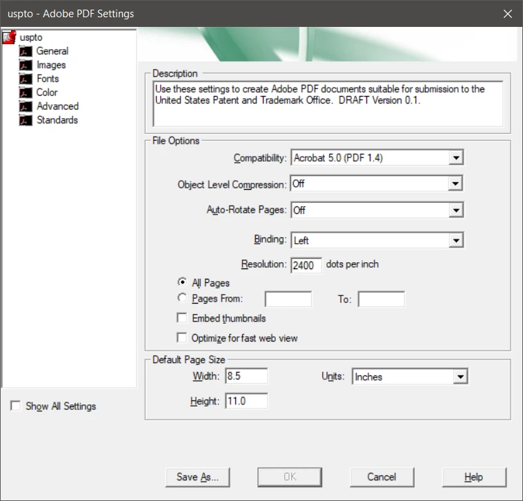

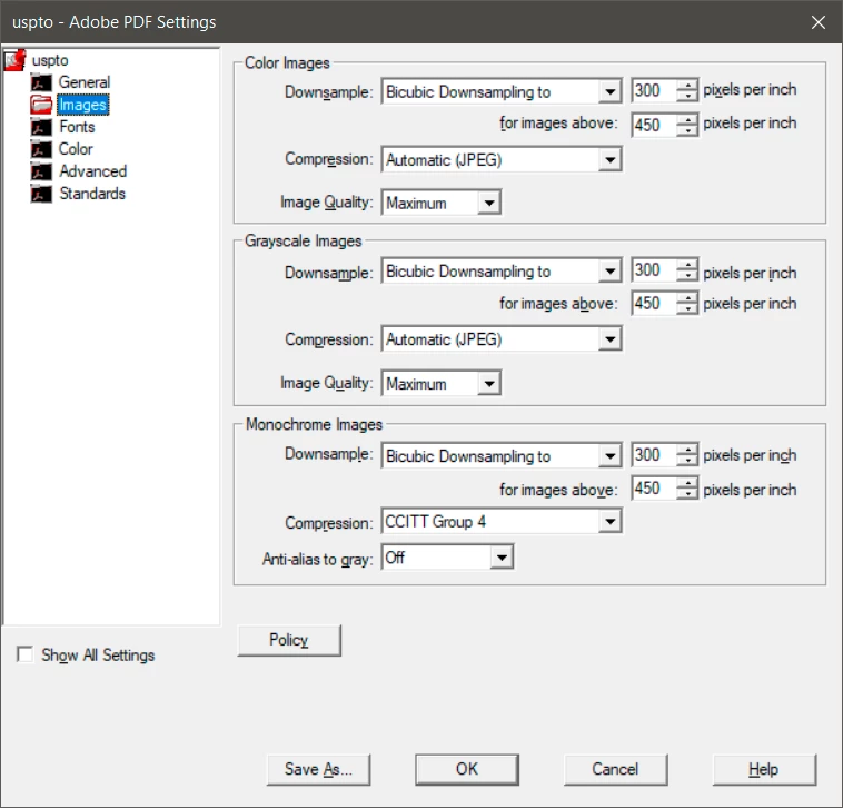

Attached file joboptions.pdf (attached) describes in detail use of the uspto.joboptions file (also attached).
Unfortunately, the joboptions.pdf and the uppto.joboptions files both date back to 2006, over eleven years ago. Much of what is described has changed since then including options in Acrobat.
Issues with the uspto.joboptions:
The compatibility is specified as Acrobat 5.0 (PDF 1.4) when in fact USPTO allows for PDF 1.6. Furthermore, unless you have at least PDF 1.5, you end up with a bloated PDF file since Object level compression cannot be set to maximum – changing this doesn't violate any USPTO specifications:
The images settings also make no sense. If you have totally monochrome drawings (no gray, simple bi-level), 300dpi is generally inadequate for viewing or printing. 600dpi or 1200dpi. Again, changing this does not violate any USPTO specifications:
The color settings are also screwy! The Color Management Policy of Convert All Colors to sRGB is wrong, wrong, wrong! For what the USPTO is using PDF for, you are best off to set this to Leave Color Unchanged. This would leave any color coming in unchanged from what you specify in the original layout program. (On Windows, grayscale and black should never be converted to sRGB!)
All other settings are relatively benign!
